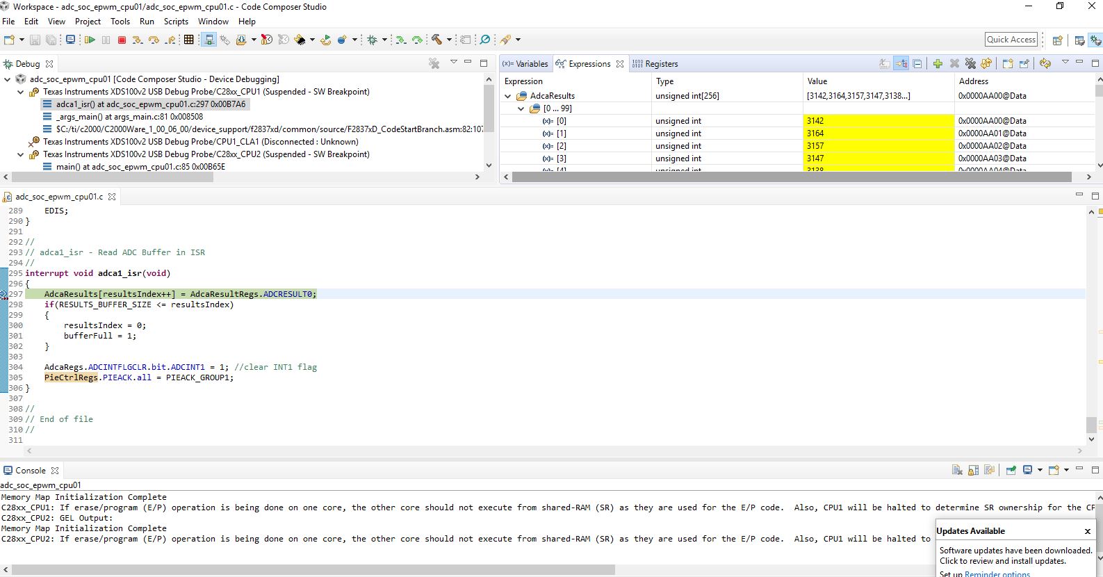

Hi E2E team,
I am using adc_soc_epwm example from C2000ware for launchpad. I am reading values which are slightly deviated from my expectation. the ground of sensing circuit is common with launchpad's ground still I am seeing this deviation. I have attached images of both data read by Launchpad and what my multimeter shows. Please help me to figure out an issue.
for 2.308 I was expecting ADC read value as : 2865 but I am getting values approx equal to 2.5354248046875.
How much tolerance I should expect?
Let me know if I am missing something.
THanks

    Refer to the schematic for the F28379D launchpad in C2000ware in \ti\c2000\C2000Ware_1_00_05_00\boards\LaunchPads\LAUNCHXL_F28379D\R2.0
    The VREFHI of the device is provided by REF5030, which is 3.0V.
    (2.3088/3.0)*4096 = 3152
    So it seems like the conversion results are roughly as expected (albeit very noisy based on your screen capture).
    Note that the device datasheet specifies the expected accuracy via the gain error, offset error, and INL/DNL specifications.
    If you have a low noise DC input, I'd expect a code spread of 2-4 LSBs over a small number of conversions (e.g. 64 conversions).
