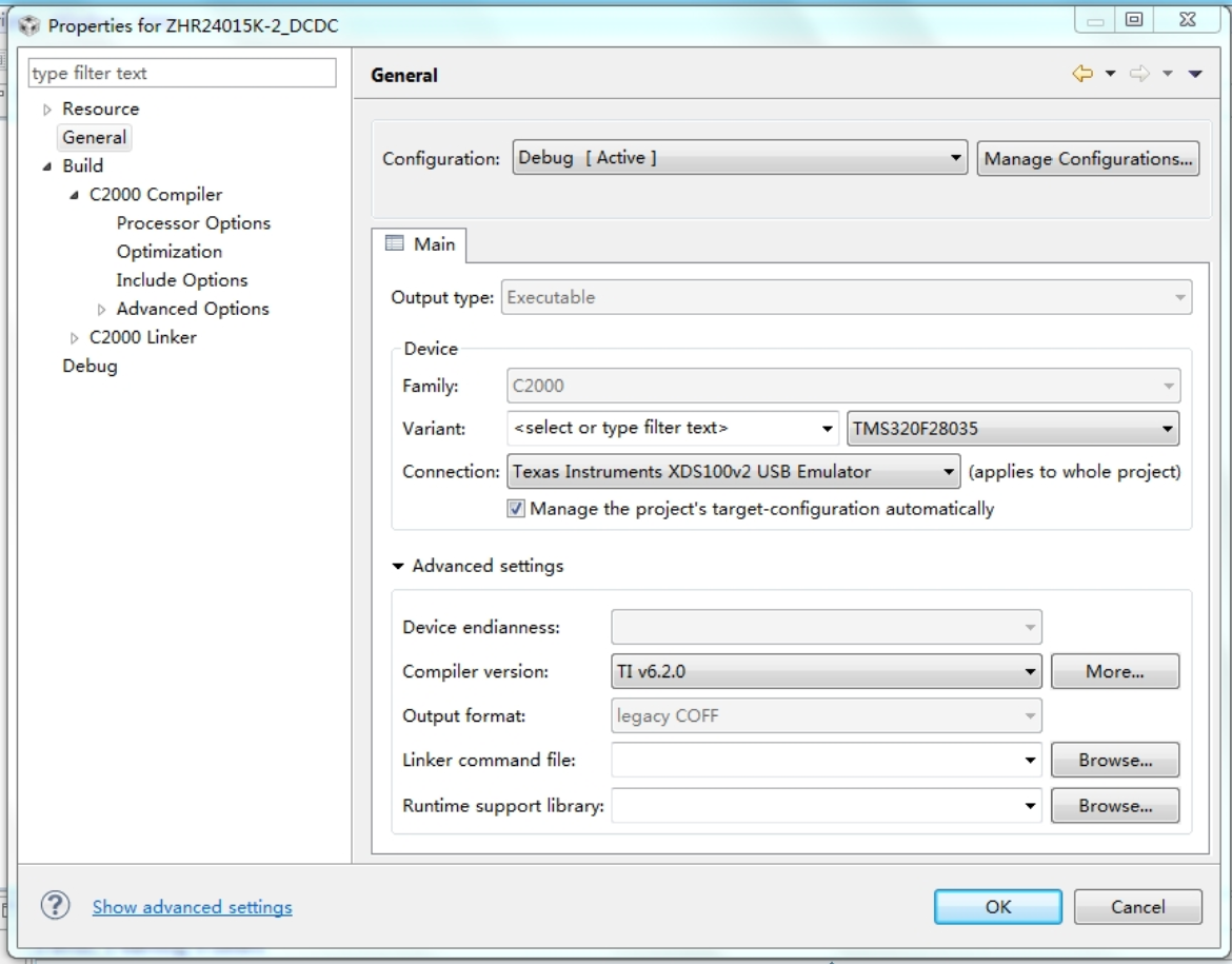

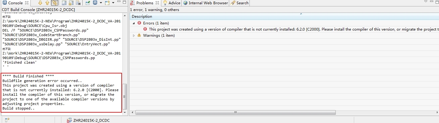

2# After "build the project", there will show the below error.
- Customer has installed the v6.2.0 compiler already, as the last figure shown.

    For issue #2, please ask them to ensure that all paths (CCS installation, workspace directory, etc) do not contain non-alphanumeric characters.
    https://e2e.ti.com/support/tools/ccs/f/81/t/740719
    If after checking these points, the build error still persists, please zip up their project and attach it here for us to look at.
