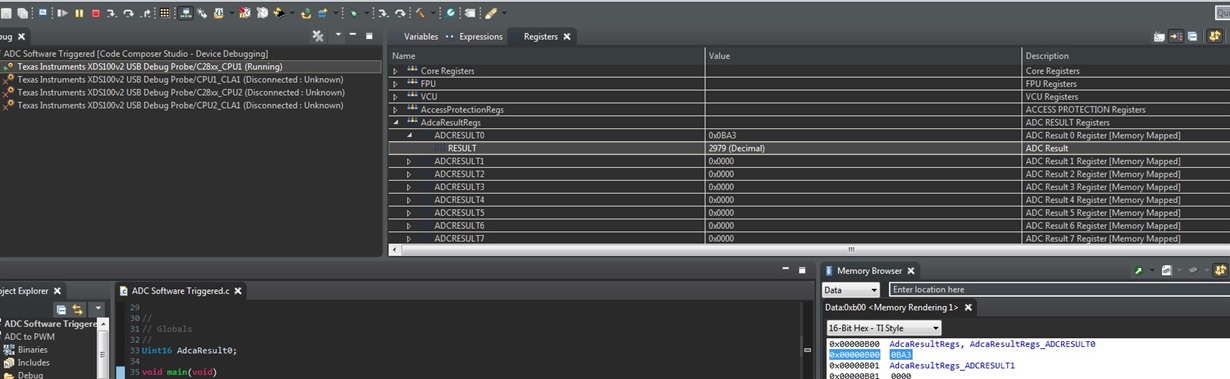

I run this code but it only executes once. I want to run this code continuously. Can't figure out what wrong i am doing.
  • Hi Gerrard,
    The above code looks correct. This should run continuously. How are you determining that this code executes only once?
    Vasudha
  • I am using the CCS Debug Feature as shown in the picture below. . If you see Debug mode is on. For viewing the register value continuously. I have turned on the continuous refresh mode. At ADC channel 0, i have used a 10k variable resistor with a 3.3 volt from TM320F28379D. ADC runs only once not continuously.

  • This is the main code file
  • Hi Gerrard,
    The below line of code is the problem. The code isn't running at all and is stuck in the while loop waiting for INT1 flag. Currently, the code is configured to set INT1 flag once SOC1 conversion is complete. Change it to zero.
    AdcaRegs.ADCINTSEL1N2.bit.INT1SEL = 1; //end of SOC1 will set INT1 flag
    Change to below:
    AdcaRegs.ADCINTSEL1N2.bit.INT1SEL = 0; //end of SOC0 will set INT1 flag
    Vasudha
