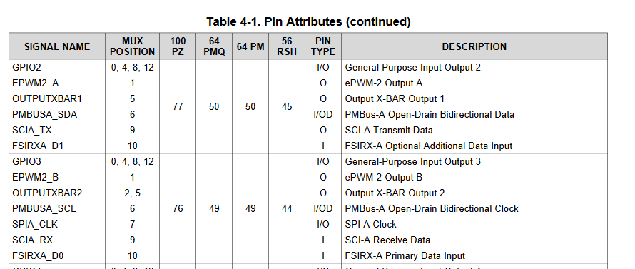

  • Thanks for the answer,
    The TMS320F280049 should support SCI on GPIO2,3 reffereing to the datasheet.
    http://www.ti.com/lit/ds/symlink/tms320f280049.pdf
    I am not using the API, because I had some trouble with it.
    To use InitSysCtrl() for example, I had to delete a lot of the lines for activating periphal clocks in InitPeriphalClocks();
    I think the 64pin version does not support all registers, the bigger versions support.
    Is there maybe a way to tell the API which package I use?
    MEGHANA MANAVAZHI said:
    Please check Table 7-8. GPIO Muxed Pins for details on the same .
    Where can I find this table?
    Table 8.5 in the Technical refference tells me the same as the Datasheet.

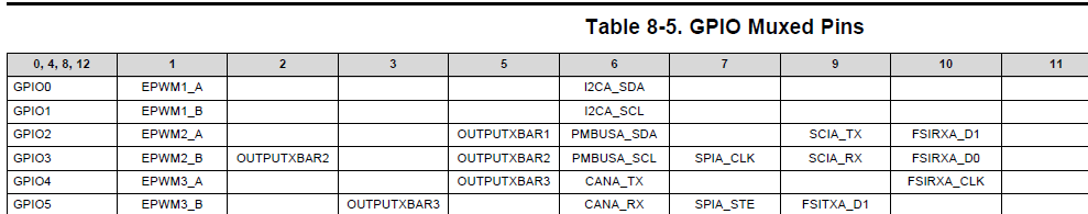

  • Hi Sebastian ,
    My apologies.  I guess i checked the TRM of another device family.
    You are right. You should be able to use the GPIO2 and GPIO3 as per Table 8-5. GPIO Muxed Pins of the TRM .
    Please use the below configurations and let me know if it works.
    GPIO_SetupPinMux(3, GPIO_MUX_CPU1, 9);
    GPIO_SetupPinOptions(3, GPIO_INPUT, GPIO_PUSHPULL);
    GPIO_SetupPinMux(2, GPIO_MUX_CPU1, 9);
    GPIO_SetupPinOptions(2, GPIO_OUTPUT, GPIO_ASYNC);
    The APIs like InitSysCtrl()  are written keeping the superset device in mind .
    The only differentiation we have is based on the configurations for Launchpad vs the controlcard in the driverlib variant of examples.
    C2000Ware\device_support\f28004x\examples
    But not based on the packages.
    Regards.
