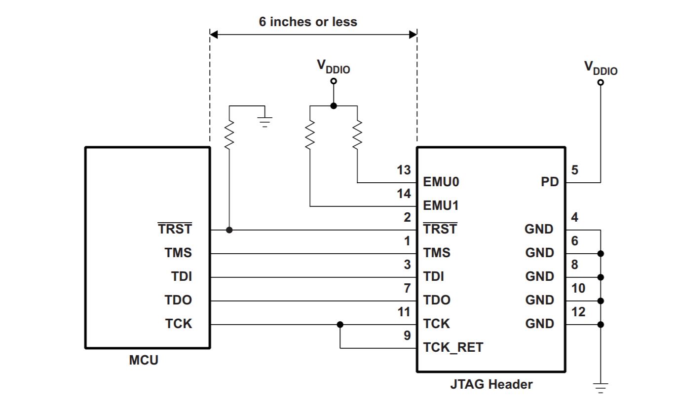

I'm a new PCB designer and I was hoping to get some assistance related to the TMS320F28069 and the TMDSEMU110-U debugging tool.  I'm currently working on a custom PCB for the 2806 chip and I'm now trying to figure out what I must include to be able to debug my project.  From the 2806 datasheet I see that I must make these connections to a 14 pin header.
This header can then connect to the TMDSEMU110-U but I can't seem to find what size the header needs to be or if it should be male or female.  Can anyone provide me with a bit of information on this?  Also, is there anything I should be aware of when routing the traces for debugging?
