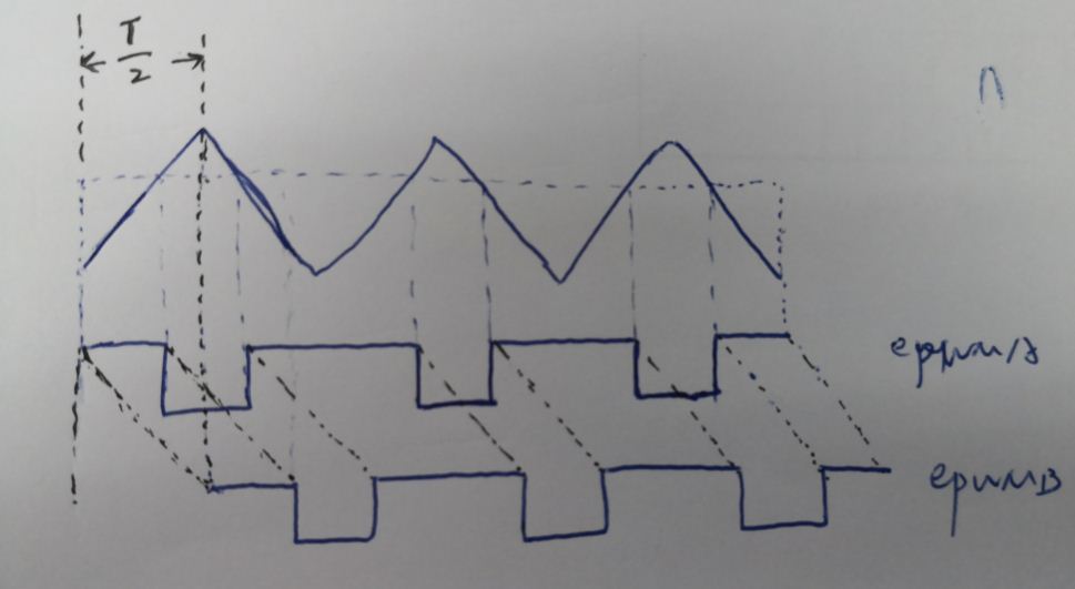

Hi Ronnie,
You could use the Time base Phase(TBPHS) and the Synchronization feature in ePWM to achieve what you desire. Please refer to the Technical reference manual in the Time base sub module section of ePWM module for more details on this. Let me know if you need any more help on this.
