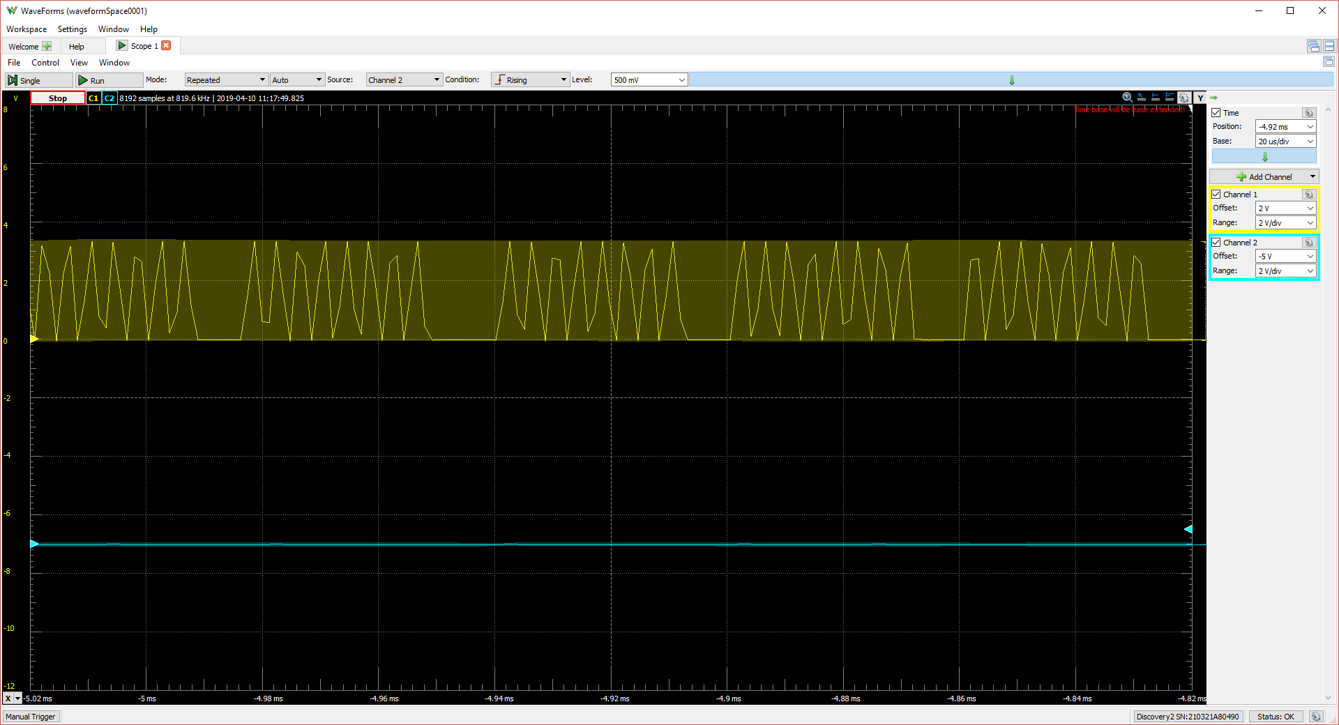

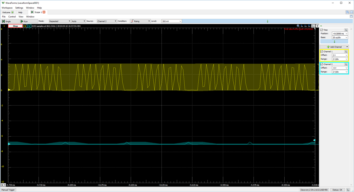

    Some Scope captures (note, not the best scope)
    The following image shows channel 1 as the clock and channel 2 as the chip enable
    Note, enable signal is low when transmitting.
    The following image shows channel 1 again as the clock and channel 2 now as the SIMO pin.

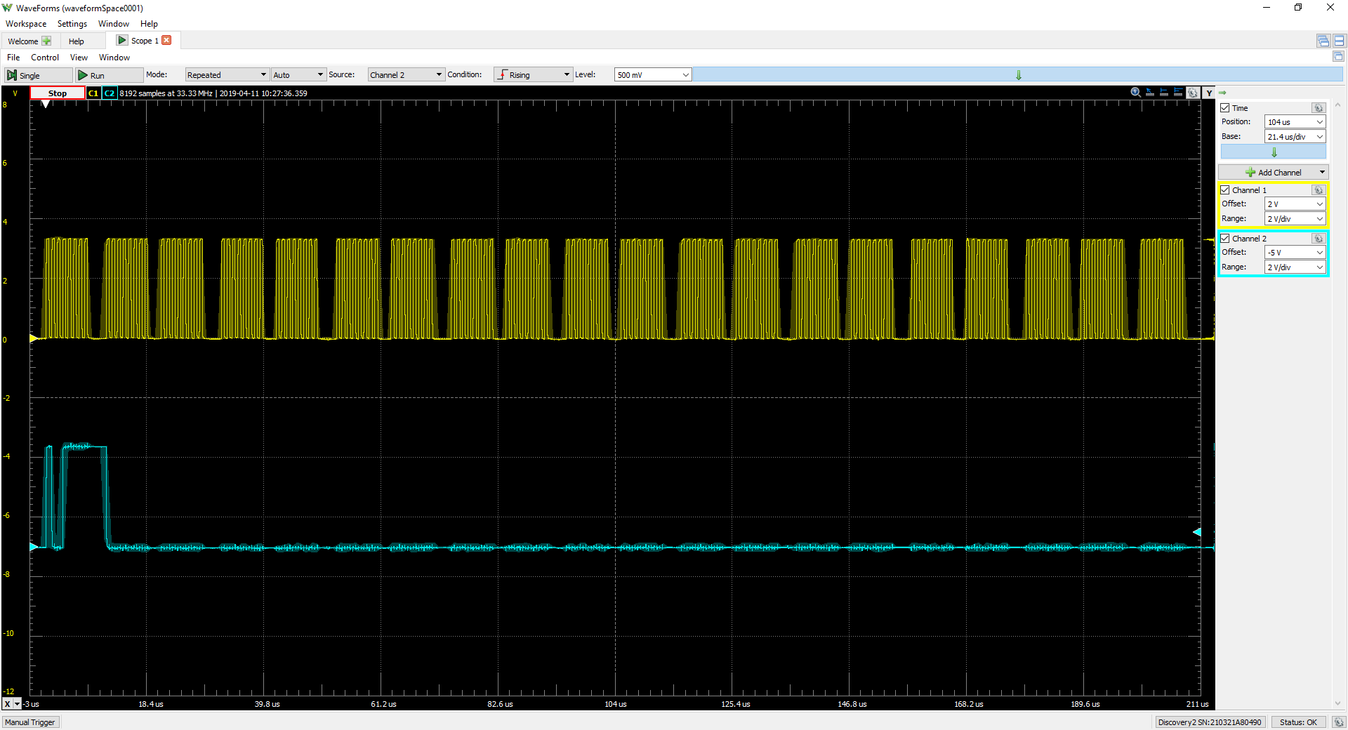

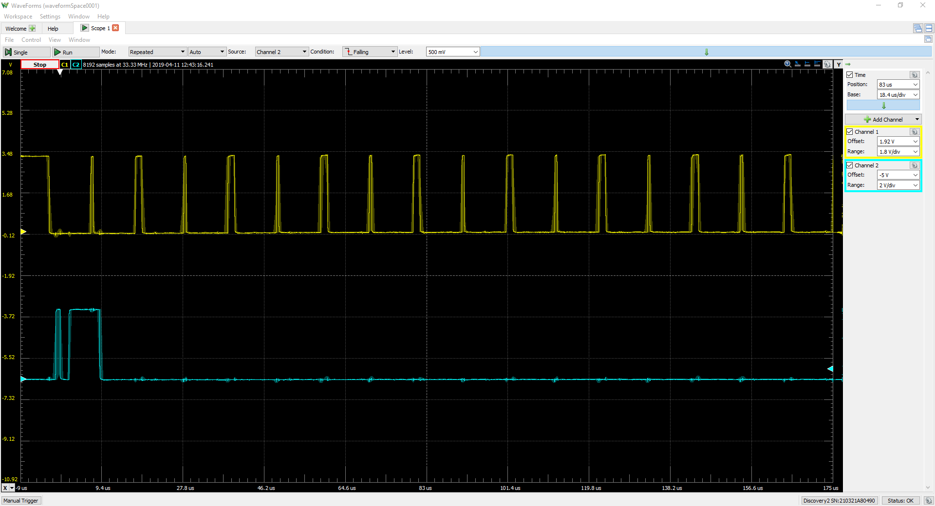

    I fixed this issue now. I am seeing the expected data on the scope for SPISIMO, but my SPISOMI looks odd coming back from my external flash.
    Do you have any thoughts on what might be causing this? At any rate, I think that my logic is sound now, but I am unsure if a setting is perhaps causing this.
    Here is an image showing Channel 1 Clock and Channel 2 SPISIMO.
    Here is an image showing Channel 1 SPISOMI and Channel 2 SPISIMO.
    Here is an image showing Channel 1 SPISOMI and Channel 2 Clock
