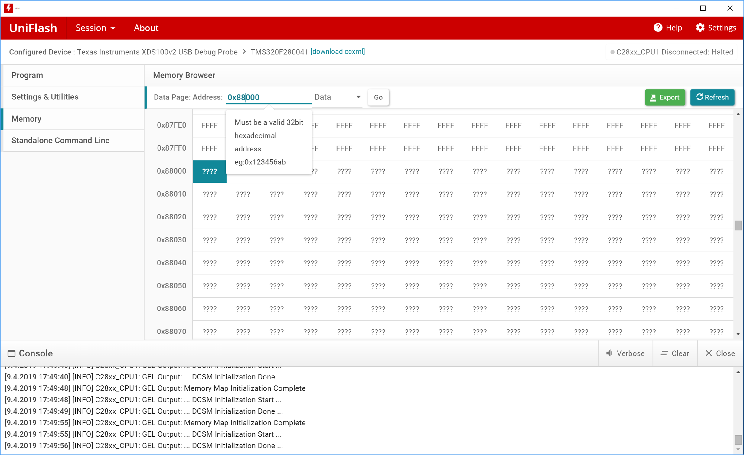

Noteworthy thing is also that when the firmware is loaded by Flash API (regardless if successful or not) and I want to see the actual data in the flash and I do memory readback (actual readback OR verify of a hex file that I have loaded using my bootloader) in Uniflash I get this error:
[ERROR] C28xx_CPU1: File Loader: Verification failed: Memory map prevented reading 0x88000@Program
or for readback:
Which seems to randomly appear on 88000, 89000 or 8a0000 start address... Which makes whole debugging more difficult..
Now the exact same happens now if I load the hex file using Uniflash (but the firmware boots which means that it successfully loads.
And it also happend if I ask flash api to erase sectors (Bank0 sector 3 through 10) all sectors before sector 8 read back 0xFFFF on all addresses, but sector 8 again shows ???? instead with error message about memory map preventing reading.
And this is only cured (i.e. I see 0xFFFF if I do erase of sectors 3 thorugh 10 using Uniflash instead... (after this bootloader also successfully loads firmware which makes sense a sector 8 is now correctly erased...)

  • Bruno,
    Please note that UniFlash uses the same Flash API as the low level driver for Flash operations.
    Regarding the UniFlash read back issue: I think it is due to a gel file bug (Check the gel file provided at ti\uniflash_4.6.0\deskdb\content\TICloudAgent\win\ccs_base\emulation\gel\f280041.gel.
    In the function hotmenu F280041_Memory_Map(), you will notice that the Flash bank memory map is incorrect (as below).
       GEL_MapAddStr(0x00080000,1, 0x8000, "R|AS2",0);                      /*   FLASH BANK1 (64 KBytes)                                */
       GEL_MapAddStr(0x00090000,1, 0x8000, "R|AS2",0);                      /*   FLASH BANK2 (64 KBytes)                                */
    It should be:
       GEL_MapAddStr(0x00080000,1, 0x10000, "R|AS2",0);                      /*   FLASH BANK1 (128 KBytes)                                */
    I will file a ticket to fix this bug.

  • Thnak You Vamsi!
    Indeed this has fixed the readback problem... Now I can see that there is the "old" firmware data.. so the erase does not work for me for sector 8.. I'll try to limit the code on my side to just erase the bank 8 and see if I can create a minimal example that would run standalone...
