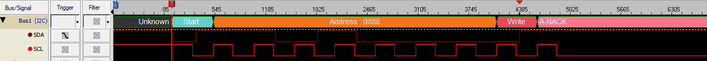

I would like port code from ATMEGA to the F28379 but MPU6050 breakboard don't send ACK when it receive his address
Electricaly, evrything is OK (of course, the MPU6050 breakboard is working, I check with an ATMEGA64)

  • Of course, I checked the breakboard and address: it works
    and according to the logic analizer this is the good value sent on the bus
