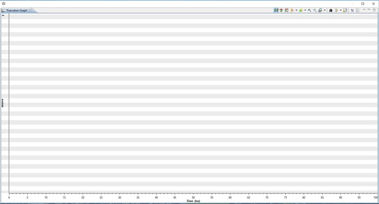

I would like to observe the execution of my application's Tasks, Hwis, Swis and so on. Therefore I'd ike to use the execution analysis tool with its execution graph.
When I run my code for approximately 10-15 seconds then suspend it and then open the RTOS Analyzer -> Execution Analysis the Execution Graph doesn't show any data.

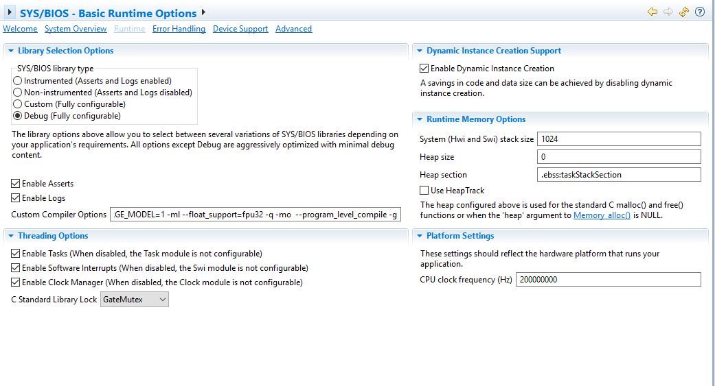

This is a screenshot of my SYS/BIOS:

And finally this is a screenshot of my empty Execution Graph:

  • Hi Alexander,
    What version of CCS are you using? 8.3 and 9.0 have a bug for C2000 devices. It will be fixed in 9.1 (and it works in pre-8.3 versions also). 9.1 is slated for May or June timeframe.

  • Alexander,
    The records are being generated on the target. The bug in 8.3 (and 9.0) is a incorrect parsing of the 16-bit bytes on C28 devices. It occurred when moving CCS to 64-bit on Windows. So your two options are move to 8.2 or wait until 9.1.
