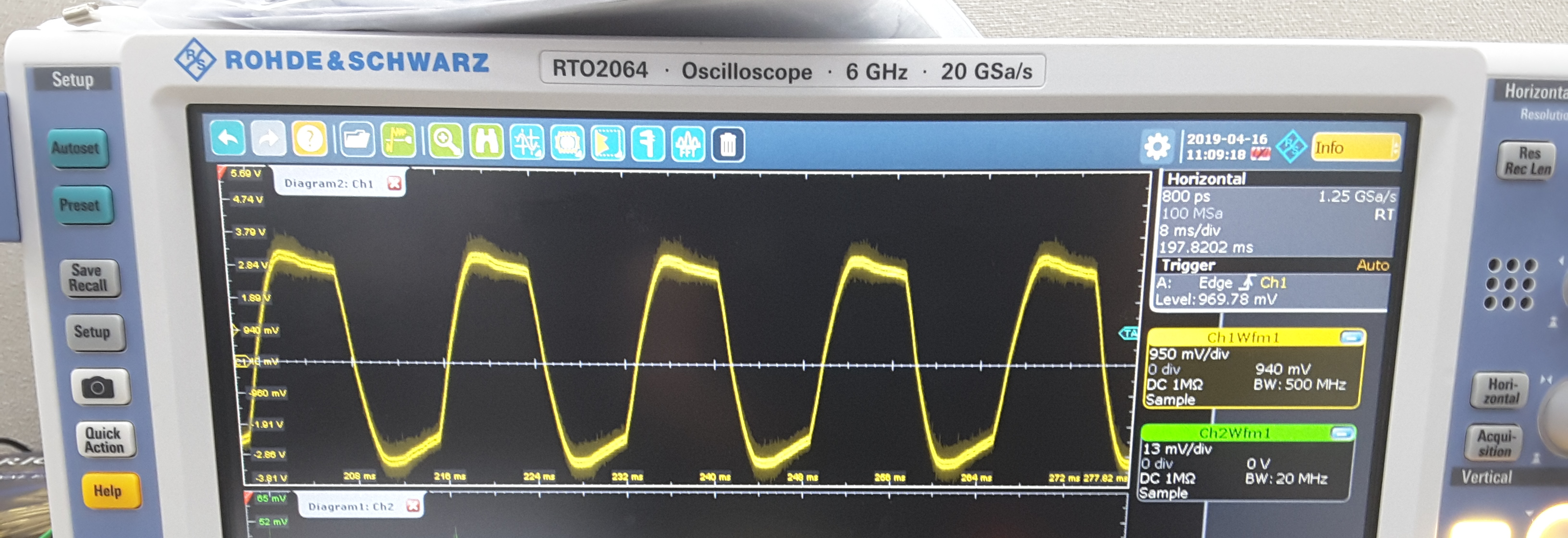

We are connecting an oscilloscope to check an output signal for CAN_HI signal. Unfortunately the signal does not look like a CAN bus message transmission. A photo is attached here. The PCAN adapter does recognize it as a CAN message and does not receive anything.

    I presume your scope is capable of triggering on CAN bus signals. Did you configure the bit-rate correctly on the scope?Have you tried triggering on CANTX pin of the DSP? If the scope does not decode the waveform, make sure input threshold value for the channel is correct. This is similar to the “trigger level” that is normally used for signals.
    Your scope readout says 8ms/div. What you are seeing is definitely not a CAN signal. If the waveform acquisition is proper, you should see something similar to the below: (note that a different MSGID & data are transmitted below, compared to what example you are using does)

    Our oscilloscope has no special CAN bus capability. We have 2 extra CAN to USB interface devices: (1) Vector VN1630A, (2) Peak PCAN USB Pro. Both we used to test our oscilloscope CAN signal capabilities. We just transmitted in loop the same CAN messages and we got pictures (below) that are very similar to your attached oscilloscope screenshot. From these tests we can make conclusion that our oscilloscope is capable to display a proper CAN signal.
    Vector VN 1630A Peak PCAN USB Pro
    > Also we connected an oscilloscope probe to CANTXA (GPIO31) pin on our TMS320F28335 module (the module is soldered by local company, link: http://syncworks.co.kr/shop/goods/goods_view.php?&goodsno=200902378&category=), running the TX_LOOP_A application, and we finally got the following picture which is similar to our previous we got from transceiver CAN_HI signal.
    Unfortunately, it does not look like a CAN signal as well.
    Agree. Having a CAN trigger capability makes it very easy to acquire/decode CAN waveforms, but you should be able to capture the activity on a scope without this capability as well.
