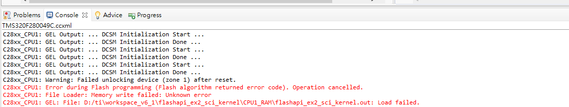

I tested my program in CCS successfully. When I added DCSM to test it, I got fail from CCS.
The following is the .cmd file.

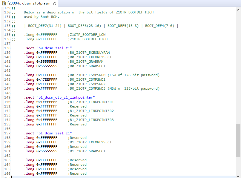

And the Following is the .asm file.
When I build and run the program, I got some issues.
I reconnected the device and read the OTP area, the GRABRAM and GRABSECT could be programmed successfully, but the CSMPSWD1 could not.
could you provide us with some suggestions?

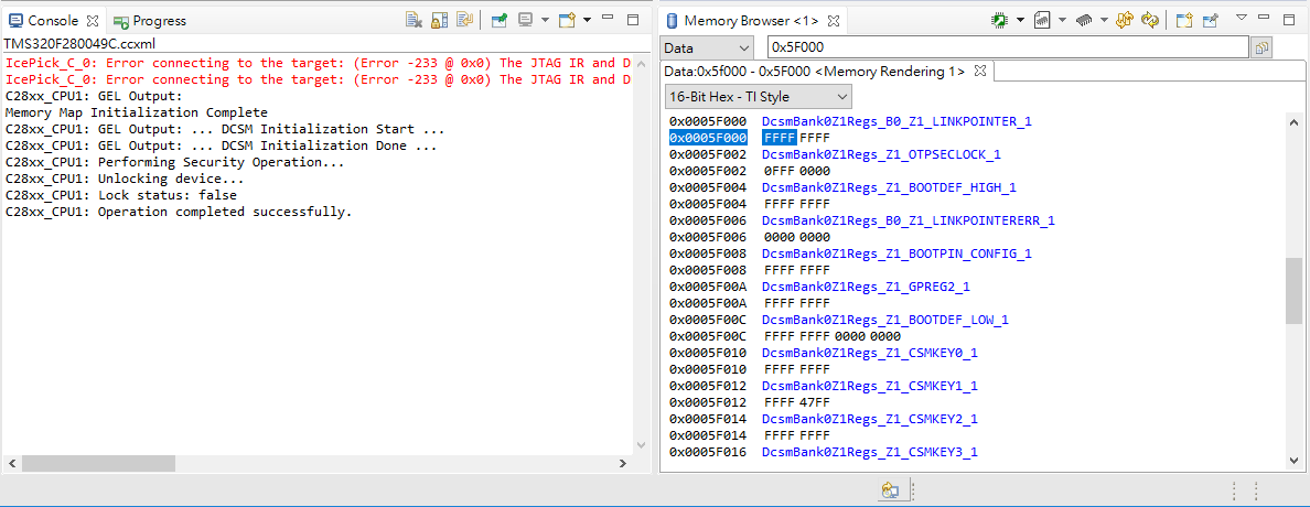

    Paste the snapshot of memory Browser showing the DCSM registers space(0x5F000 ) after attempting to unlock the zone. We can look at those registers to see if there is anything else that is causing this problem.

    The following is DCSM.

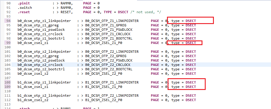

    And the following is .cmd file.

  • Also, Its good if you can take the put the snapshot of the memory section of the .cmd file as well (the section where you define the memory boundaries). I am looking for the memory assignment of each of the above sections.

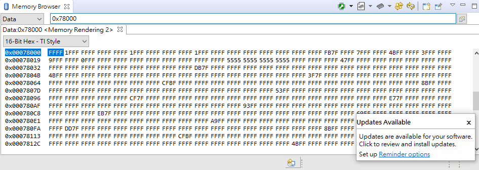

    I remove the symbols and the following is the OTP area.
    The GRABRAM and GRABSECT were correct, but the CSMPSWD1 was not 0x47EEFFFF.

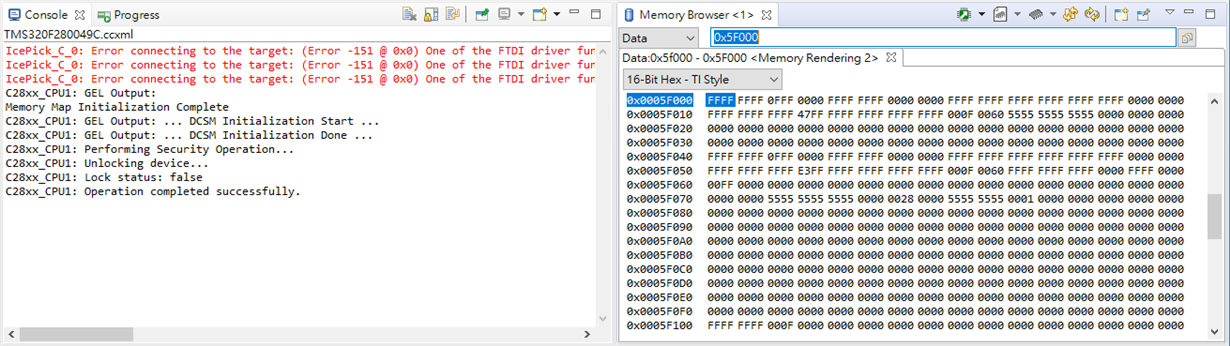

  • Hi Raphael,
    Got the issue. Please take a look at the memory 0x5F07A. The SECERRSTAT register is set to 1 which means there was an error while loading the Security Configuration from USER OTP. Usually this happens when there is an ECC error while attempting to program the OTP and hence the security settings aren’t reliable anymore.
    Please move on to the next Zone Select Block(ZSB1) by changing the link pointer and reconfigure the GRAB settings and the CSMPSWD for that particular ZSB. Also double check the values you are programming and ensure that you are programming the OTP properly.

    I got a new problem If I didn't write DCSM and set DSECT to DCSM.
    The following are my settings.
    I could execute my program successfully with this setting.
    However, the program could not be executed successfully when I wrote the DSCM to device and unlocked it.
    The program was breaking at 0x3FBD93.
    Do you have any suggestions?
