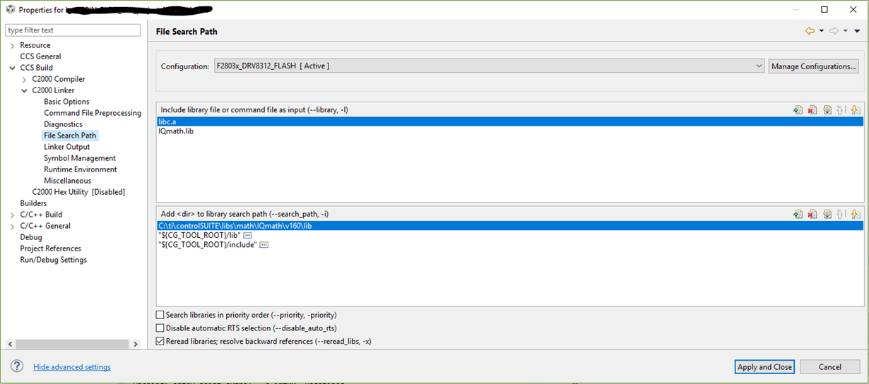

I am using Code Composer Studio Version 8.0.0.00016 to program a TMS320F28035 microcontroller.
I want to use the IQmath library (especially _IQdiv).
Therefore I included the Headerfile IQmathLib.h and IQmath.lib in file search path as shwon in the attached picture.
But if I try to compile my project, I get the following warning:
>> Compilation failure
makefile:165: recipe for target xxx.out' failed
undefined first referenced
symbol in file
FD$$MPY ./yyy.obj
FD$$TOL ./yyy.obj
FS$$ADD ./yyy.obj
FS$$DIV ./yyy.obj
FS$$MPY ./yyy.obj
FS$$TOFD ./yyy.obj
FS$$TOL ./yyy.obj
FS$$TOU ./yyy.obj
FS$$TOUL ./yyy.obj
L$$TOFS ./yyy.obj
LL$$AND ../lib/commros_28xx_c_full.lib<commros.obj>
LL$$CMP ../lib/commros_28xx_c_full.lib<Datalogger.obj>
LL$$OR ../lib/commros_28xx_c_full.lib<commros.obj>
U$$TOFS ./yyy.obj
UL$$TOFS ./zzz.obj
_memset ./zzz.obj
error: unresolved symbols remain
error: errors encountered during linking;
"xxx.out" not built
gmake: *** [xxx.out] Error 1
gmake: Target 'all' not remade because of errors.
**** Build Finished ****
Can you help me here, please?
Thanks in advance,
Sarah

  • Hey Sira,
    I found the 28035_IQsampleC project in controlSUITE, but it wasn't possible to import it in ccs.
    When I selected the search-directory in the Import GUI, ccs discovered no projects.
    And I don't have C2000Ware...
    Referring to www.ti.com/.../controlsuite under "Features" IQMath library is part of controlSUITE.
    In the related thread (https://e2e.ti.com/support/microcontrollers/c2000/f/171/t/225128) somebody had exactly the same problem, I have, and he solved it by adding the IQMath.lib-File in the "File Search Path".
    This one is what I have done, too, as you can see in my last post. Therefore I used the instructions under e2e.ti.com/.../612994 . But it didn't help.
    Browsing the internet I found out, that I maybe missed some settings in "include options".
    But I have no idea, how to set everything correctly...
    I am a little bit desperate.
    I attached a picture of my current "include options".
    Something that attracted my attention is, that there are some warnings. I attached a picture of them, too. The same paths are also greyed out in the include folder of my project.
    If I go to the disguised path in my file explorer outside ccs, I can't find the following folders written down in the warnngs. There is just a file called ".project" and two different folders.
    I have no more idea, which setting to set or correct...
    Can you please help me here?
    Thanks in advance,
    Sarah

  • Hey Sira,
    Thanks for help.
    I checked the linker file an found no relevant difference to the example.
    But I found out the problem myself: The warning warning entry point symbol _c_int00 undefined was the root,
    which causes all the following problems.
    Referring to processors.wiki.ti.com/.../C28x_Code_Generation_Tips_and_Tricks the rts library defines the _c_int00 bootstrap routine.
    I think, this is somehow needed to include the IQmath.lib correctly.
    So what I had to do, was including the rts2800_ml.lib.
    After that my settings in File search path look like:
    Now I am able to build my project.
    One more time: Thank you for help!
