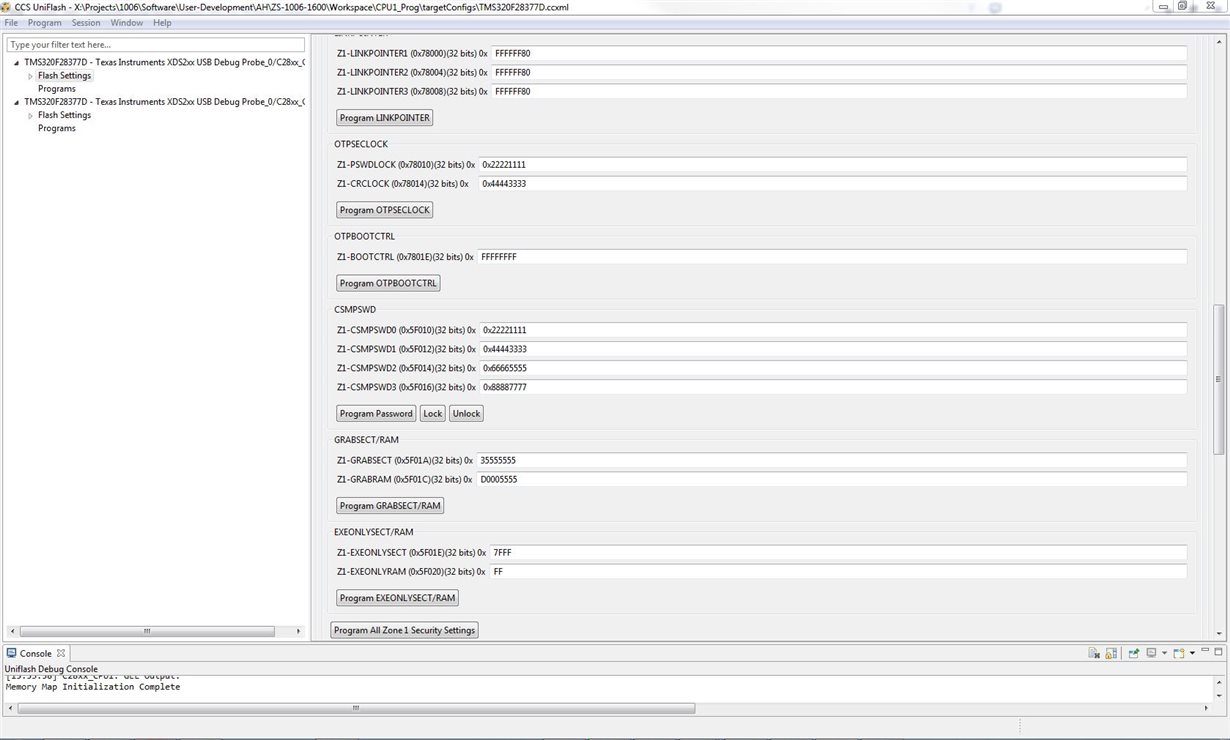

I am trying to implement CSM locking in F23877D control card
So I enter CMSPSWD , GRABSECT/RAM , PSWDLOCK and Program these successfully with the values as in the picture:
So after doing this , I disconnect the power and power it on again .
Then I change the CSM password value by just entering random numbers in the locations .  Go to Program and program new code to the memory.
The program successfully erases and loads the new program.
Could you tell me why this happens ? Since the memory is secure and I have entered the wrong password.

  • Hi Vivek ,
    I think the problem I am facing is with the uniflash command line .
    Let me explain below .
    In uniflash GUI , when I press on Program GRABSECT/RAM , then I can see that the memory is being programmed with the 35555555 and D0005555 values as I wanted.
    When I check the memory locations for Flash sector A , B etc , it shows 0's as values. This indicates memory is secure.
    Now when I try programming with the wrong CSM password , the programming fails as I expect.
    Now when I call the below command line in the batch file  , the process says it is successful for all the 3 operations. But when I check the the memory values for GRABSECT and GRABRAM the vales havent changed .  The CSM password however has 0's in its memory , indicating password location is secure.
    Could you tell me what is wrong with the below line for GRABSECT ,GRABRAM  and Z1GRABProgram please.
    call uniflash -ccxml X:/Projects/1006/Software/S-1006-1600/Development/Workspace/CPU1_Prog/targetConfigs/TMS320F28377D.ccxml -core "Texas Instruments XDS2xx USB Debug Probe_0/C28xx_CPU1" -loadSettings X:/Projects/1006/Software/S-1006-1600/Development/Workspace/CPU1_Prog/targetConfigs/TMS320F28377D.uniflashsession -setOptions Z1PSWDLOCK=22221111 Z1CRCLOCK=44443333 Z1CSMPSWD0=21346986 Z1CSMPSWD1=46579443 Z1CSMPSWD2=25612358 Z1CSMPSWD3=21561284 Z1GRABSECT=35555555 Z1GRABRAM=D0005555 -operation Z1GRABProgram Z1PasswordProgram Z1OTPSECCLOCKProgram
    I have also tried :
    call uniflash -ccxml X:/Projects/1006/Software/S-1006-1600/Development/Workspace/CPU1_Prog/targetConfigs/TMS320F28377D.ccxml -core "Texas Instruments XDS2xx USB Debug Probe_0/C28xx_CPU1" -loadSettings X:/Projects/1006/Software/S-1006-1600/Development/Workspace/CPU1_Prog/targetConfigs/TMS320F28377D.uniflashsession -setOptions Z1GRABSECT=35555555 Z1GRABRAM=D0005555 -operation Z1GRABProgram
    In this case as well success was reported , but no changes occurred in the memory

  • Hi Vivek ,
    I have changed the user otp linkpointer value manually in Uniflash gui and then called the called the above commands in a batch file.
    So the memory doesn't have the previous security settings anymore.
    I found another thread where the same problem was occurring :
    Do you think that the uniflash code is not right ? Let me know how I should proceed.
    Anish

  • Hi Ricky ,
    Thanks . Setting the passwords in the uniflash sessions file and then executing the batch file to call the programming commands worked.
    The command in my batch file :
    uniflash -ccxml X:/Projects/1006/Software/S-1006-1600/Development/Workspace/CPU1_Prog/targetConfigs/TMS320F28377D.ccxml -core "Texas Instruments XDS2xx USB Debug Probe_0/C28xx_CPU1" -loadSettings X:/Projects/1006/Software/S-1006-1600/Development/Workspace/CPU1_Prog/targetConfigs/TMS320F28377D.uniflashsession -operation Z1GRABProgram Z1PasswordProgram Z1OTPSECCLOCKProgram
