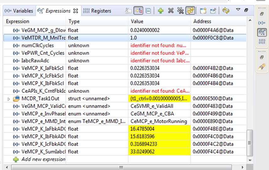

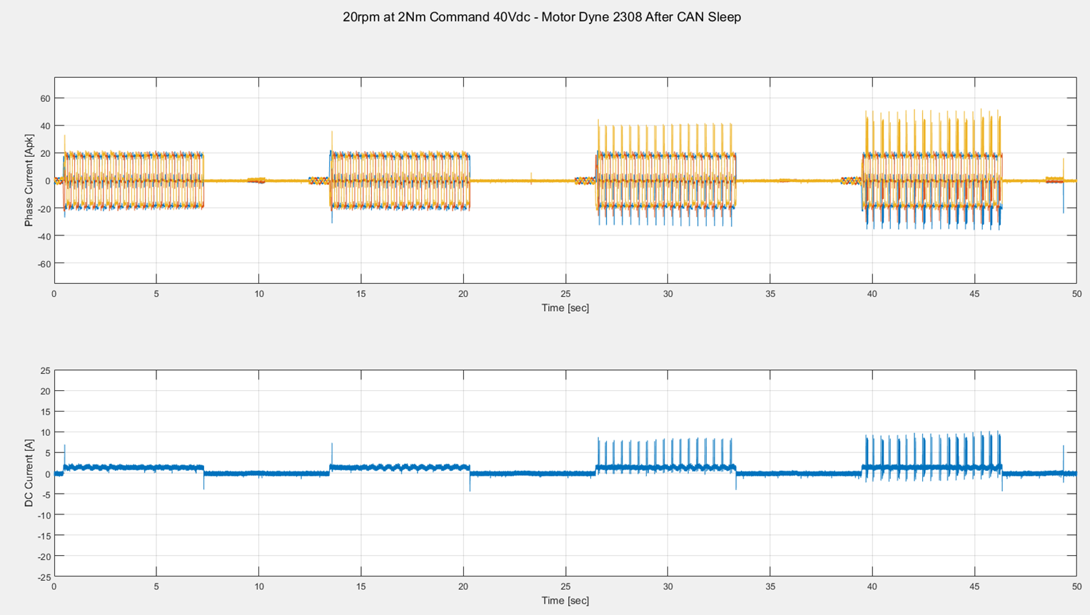

Hi C2000 Team,
We received feedback from the customer that they are seeing ADC corruption on the TMS320F28069. See below for additional details:
  • ADC corruption of the 3 phase current feedback will cause motor control to be unreliable
  • It has been observed phase C is most susceptible on motor dyne
  • TI has indicated ADC issues with this processor see SPRZ342N http://www.ti.com/lit/er/sprz342n/sprz342n.pdf

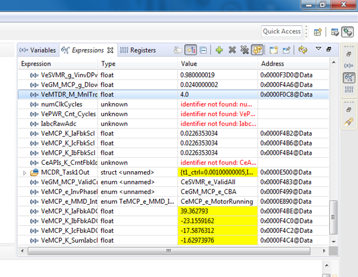

Normal ADC function, all feedback currents read.
Sum (Ia, Ib, Ic) ~= 0
Eventually Ic ADC feedback will stop reading – but oscilloscope shows really high current on the phase C
Sum (Ia, Ib, Ic) = 33
Do we have a suggested way to implement a fix?

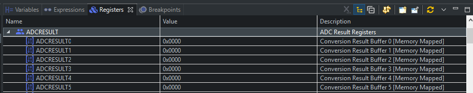

  • Hi Barend,
    It's hard to say what is going on based on the information provided. We'll need some further details to narrow down the issue and get to a possible fix.
    Could you please answer or comment on the questions below for us:
    1. Could you compare the actual ADC results (ADCRESULTx register) in a good vs. bad case and provide them? This would be instead of looking at the current measurements recorded, which is calculated based on the read ADC values
    2. Could you provide the ADC initialization code being used?
    3. As mentioned, there are several ADC advisories in the device errata. Have these been understood and have the suggested workarounds been properly implemented?
    4. Could you provide more details on when this issue seems to happen? Is there something in the application that is systematically triggering the ADC results to be bad? Does it appear to happen after a certain length of operation, i.e. what is meant by eventually? Any details you can provide around these occurrences would be helpful in diagnosing the issue.

    adc.hHi Kevin,
    Please see below for answers to the questions you need to know more about.
    1. Could you compare the actual ADC results (ADCRESULTx register) in a good vs. bad case and provide them? This would be instead of looking at the current measurements recorded, which is calculated based on the read ADC values.
    The customer is working on finding a way to collect raw ADC through CCS, is this possible? If so, how?
    Also additional data was collected last night using scope to show measured ADC voltage reading @ ADC micro pin matching measured AC current, but reported reading by micro was incorrect (stopped updating).
    Phase C where is most susceptible is connected to ADCINA6 thought might indicate something to be last in the ADC queue.
    Attached is source code for the ADC functions (including initialization). These were created by TI to their understanding and the customer did not modify them (they are from 2015), so not sure if they contain the errata fixes.
    Currently, they are working through the ADC advisories, and have completed:
    • Initial conversion,
    • ADC result conversion when sampling ends on 14th cycle,
    • ADC revision register limitation
    • ADC can become non-responsive when ADCNONOVERLAP or RESET is called
    They are still working on the others, and would be happy to review them with us to make sure we implemented them correctly.
    The issue seems to happen after a low power sleep mode is induced and then the controller is woken back up.  It is very repeatable on the motor dyne, issue happens after 30 sleep cycles.  On the actual project it seems more random.
    Barend
  • Hi Barend,
    You can check the ADCRESULT registers in CCS using the Register window while debugging, like below. Checking the defined struct _ADC_Obj_ handler in the expressions window should work as well:
    We're specifically wanting to look at the ADC samples used to calculate the Phase C current.
    Was this project built off of one of the kits/projects in Motorware? If so which ones?
    The software provided includes the ADC function definitions/prototypes and defines. It would be more useful to see the ADC initialization code used within main() and the values configured in the ADC register. Could you provide a snapshot of the ADC registers after initialization? This can be collected using the registers window in CCS.
    Kevin
