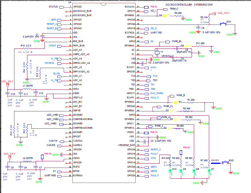

I am designing bldc motor control board using TMS320F28035. I have attached my schematic regarding interfacing of microcontroller.
I want to verify the interfacing of VDDIO(pin 36 and 70) it is done based on ref. design available in application note and ti forum.
Please let me know whether it is correct to avoid power glitch at some GPIO during startup.
