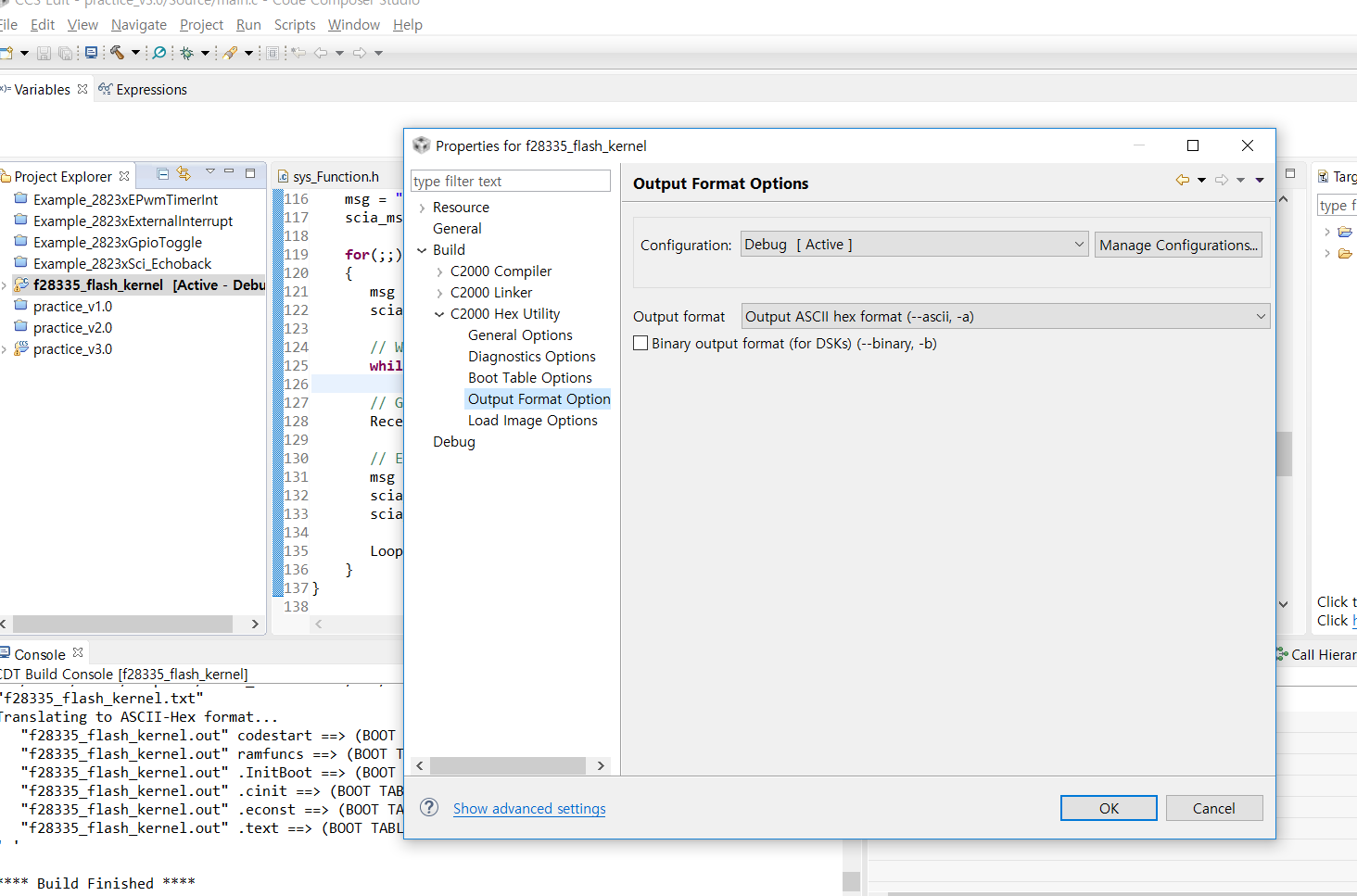

I enabled the hex2000 utility for f28335 flash kernel example in CCS and set my project property as below with a hope that I did well to produce the hex file required for SCI boot loader.
It is said the format must be in the ASCII SCI boot format, which is why I check the square boxes as the photos above.
I gave the same options to my project targeted to be load in FLASH RAM.
After the setting above from ehx2000 utility, I could see hex file. I changed the .hex extension to .txt because of the description of “6.1.1 kernels” section. “f28335_flash_kernel.txt and “practice_v3.0.txt” are the extension modified files I got after build process.

    And I noticed that during building process, with hex2000 utility on with the options I set – the option can be checked at the photo I posted on my first question –
    F28335_flash_kernel example project provided by TI produced the .text file in ASCII SCI8 fortmat automatically but my project didn’t.
    so now I am guessing it is because my project missed any header and source file or library.
    The photos below show the sources and headers included in my project that I tried to load into FLASH.

    First, make sure your post-build steps are the same for your application as for the kernel.
    Second, make sure you are booting to SCI boot mode and also using the right SCI pins for communication.
