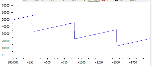

I am trying to implement a single phase PLL to determine the phase of an ac signal. I have managed to make my system measure an AC signal, and output a phase (using CCSUITE 1ph_PLL template) however the output phase of the PLL has been moving up and down and sometimes displaying terrible transients as seen in the next figs:
I also included an offset with the signal generator so that the ADC captures both positive and negative values
My ADC also displays wrong results at some values of my grid frequency (it works for 100Hz, 500Hz, 1000Hz), but it shows terrible results for 60Hz for example.

3- Also, I noticed that my graph function works for 100Hz when I have a buffer of size 500, but as I change the size of the buffer, the graph also changes, so I am thinking that maybe the system does work, but I will only see the right output at certain buffer sizes.
Any help/advice would be welcome.
Thank you,
Victor
  • you should plot something that repeats,
    also the buffer that you are using is it triggered?

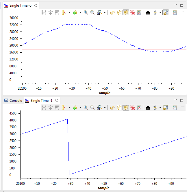

  • Dear Manish,
    I appreciate your assistance in this matter. I am currently trying to implement the triggered scope using the DLOG_4CH module.
    Should I call the function  DLOG_4CH from inside the ISR from my ADC?  (DLOG_4CH_IQ_FUNC(&dlog_4ch1)
    When I try to call the function from inside the ISR I complains that dlog_4ch1 has not been defined. And if I try to define it inside the ISR, then I lose the initialization parameters that I set for it in my main.
  • you will need to declare a global that is visible inside the the ISR and the main.c, we have several examples that use this,
    see
    C:\ti\controlSUITE\development_kits\TMDSSOLARUINVKIT_v100\MicroInv_F2803x
  • I see. I managed to do that with the command extern (so that ISR.c could use same variables from main.c). Thank you!
    Below is the graph of the PLL working at 60Hz
    One last question that I had is related to the ADC values. I am working with an ADC of 12 bits, so values range from 0 - 4095.
    When sending the measured values to the D LOG _4CH I am just sending dval1= AdcResult.ADCRESULT0<<3; However, if I wanted to send negative signals as well, instead of only positive values, what would be the best approach in this case? I thought about subtracting the average (2047) from the ADC measurements, but I am wondering if there is a better way to do this.
