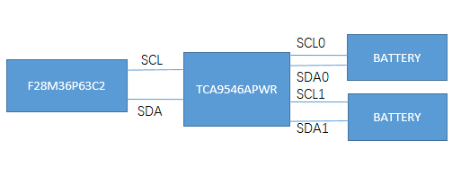

I connect TCA9546APWR(slave) and two battery(slave) by I2C.
TCA9546APWR: one channel change  to two channel.
BATTERY:read the quantity of electricity.
and when we connect and disconnect the battery ,It's randomly happened arbitration lost (I guess so...)

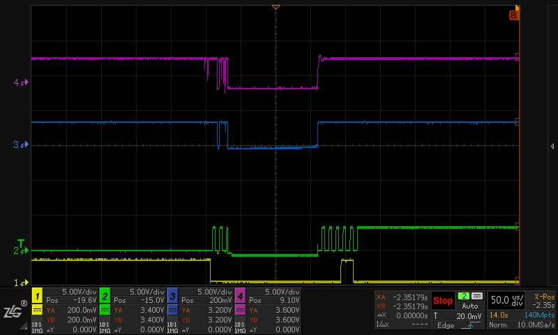

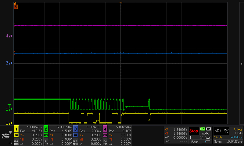

    There are two I2C physical interface for battery, Connect and disconnect means operate the physical interfa
    I probe the I2C SDA/SCL pins with an oscilloscope(Connect and disconnect teset), There has two condition of I2C.
    Green and yellow: TCA9546APWR  I2C channal 0
    purple and blue:TCA9546APWR  I2C channal 1
    1. when i disconnect the I2C1, It is randomly happened All the SCL and SDA will be pulled down by circuit noise( I guess so...), I2CMCS is 0x7A. In this condition, The I2C can not be recover.
    2. After M3 send the command,I think the slave need relay the data, but then I disconnect the battery , then SCL alway low.I2CMCS is 0X40.
    I think there has some problem on I2C bus, But After error occured , The I2C of F28M36 can not be recover from error state.

    These waveform screenshots for channel 0 and 1 are the I2C interfaces between the batteries and TCA9546APWR, correct? If the issue is along this this interface then you should probably post a question on the forum that corresponds to the TCA9546APWR device. The TI experts on the below forum will be able to speak to that device better.
    e2e.ti.com/.../138
    Is there an issue along the F28M36P63C2 and TCA9546APWR I2C interface? Have you probed this interface to see what's going on?

    Which of the waveforms provided is what the F28M36P63C2 and TCA9546APWR I2C interface looks like when the issue occurs? This isn't clear to me.
    If you reset the TCA9546APWR and that causes the F28M36P63C2 to get into a confused state you should likely reset the I2C module on the F28M36P63C2 . You can try disabling and re-enabling the I2C master bit, i.e. set I2CMR.bit.MFE to 0 and then 1. You should integrate proper error handling for this situation.
    Kevin
    -->The waveforms like below when issue occured, It is same with the Battery and TCA9546APWR I2C interface
