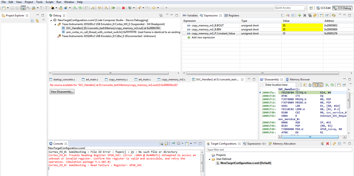

I'm trying to copy a constant from an input port to a specific address in the shared memory, the program is running on the M3 core. unfortunately, It didn't work.
for some addresses, Code Composer Studio stop running and exit automatically (for example 20009FF0 and 20008000 in S0 RAM).
for some other addresses, the program copies the value but the M3 core stop running (for example 2000AAAA in S1 RAM).
for other addresses, the program still running but enable to copy the value.
  How can I found the best address to do that?

  • Yahya,
    It sounds like you may be running out of memory in your application. Can you try expanding or combining memory blocks as explained here: processors.wiki.ti.com/.../C28x_Compiler_-_Understanding_Linking and seeing if that helps address the conditions in which it stops running.
    I would also recommend you start out with the linker command file templates provided in controlSUITE
    Ozino

  • Hi Ozino;
    when the program copies the value and the M3 core stop running the following message occurs in CCS's console:
    Cortex_M3_0: SemiHosting : File IO Error : fopen() : ÿÿ : No such file or directory
    Cortex_M3_0: Trouble Reading Register SPSR_SVC: (Error -1064 @ 0x400271) Attempted to access an unknown or invalid register. Confirm the register is valid and accessible, and retry the operation. (Emulation package 5.1.507.0)
    Cortex_M3_0: SemiHosting : Read Failure : Register: SPSR_SVC
    Best Regards;
    Yahya;
  • Yahya,
    With regards to the Sx RAM blocks, have you correctly configured memory subsystem to use Sx-0 RAM as Shared memory?
    If not, please checkout the TRM chapters on Sx RAM and configuraing the mem configuration register(pg 84, 191, 487) in spruhe8d.
    Here is a forum post below with a similar issue:
    e2e.ti.com/.../267543
    Ozino
  • Hi Ozino;
    thank you very much for your help; you're right, I must give the ownership of the shared memory blocks to the C28 processor, by setting the appropriate bits in the
     Sx SHRAM Master Select Register (MSxMSEL) (spruhe8d page 480); Now it works fine.
