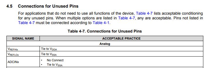

I am before producing a new board design which include TMS320F28377D.
Not all of the ADC pins are in use, my question is what to do with the unused pins? To left un connected or to tie to VSSA (analog ground).
From the Datasheet (see attach) it is unclear.
