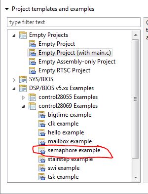

  • Thanks for following up Lori. I am still trying to figure out to implement the new code into my current code, specifically Bios linker file.
  • Hi Lori,
    I am trying to add a space for CRC_TABLE in my flash and having an issue using the config tool (tcf). I can modify the configuration tool without complains but no update in the xxcfg.cmd. I am confused and hope you can help me to go through.
    Zaw

  • Hi Zaw,
    Can you please post your .tcf file?
    Janet
  • environment["ti.bios.oldMemoryNames"] = true;

  • Ok, I have not tried this with CCS 7.  I tried CCS 5.5 and 6.2.  Let me try CCS7 and get back to you.
    Janet
  • Hi Zaw,
    I tried importing and building a DSP/BIOS program in CCS7.0.  You can import the example project by selecting:
        File -> New -> CCS Project
    Select the target (I chose 2806x Piccolo since I have that device), the target connection, and choose a name for your project.  Expand the "DSP/BIOS v5.xx Examples" in the "Project templates and examples", and choose one:
  • Hi Janet,
    Great, I have a similar lauchPad with 28069M. I built the example as you mentioned above and got some defined errors. I think I am missing some headers or config files.
