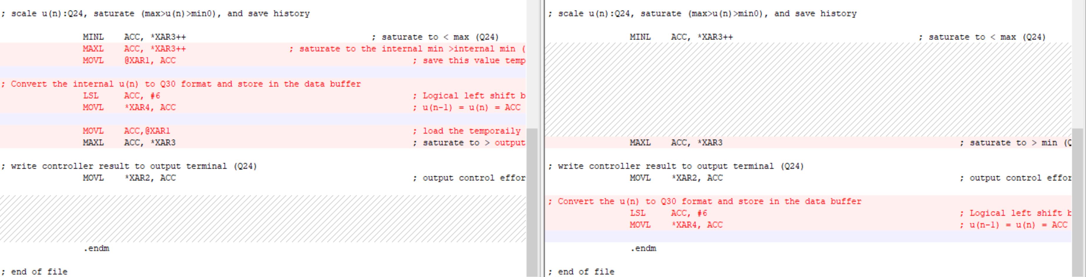

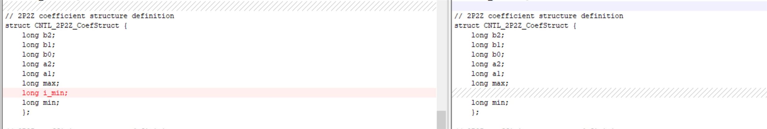

It defines a data structure for the coefficients of the CNTL_2P2Z: 2-pole 2-zero library. The struct definition defines 8 elements, but when compared to the assembler code it appears to only access 7.

Due to the location of the new variable added in the header file, the assembler macro accesses when then turns out to be an uninitialised variable, resulting in some rather strange behaviour of the controller. This appear to have occurred between the transition from v3.3 of the library to v3.5.

    If you see the assembly code, it is accessing all 8 locations
    coeff is pointed to by XAR3, see accessed in line 80, 82, 84, 86, 88, 93, 94 and 102.

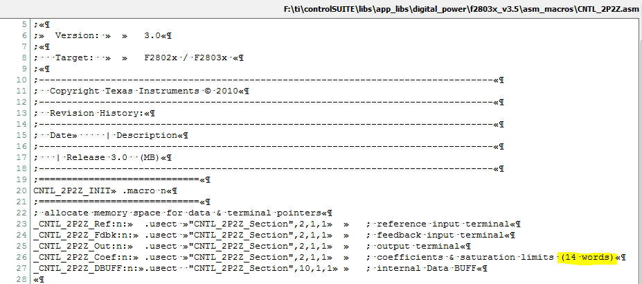

    thanks for your prompt reply. You are correct that the newer version of the assembler macro does use the new variable, however i was thrown by the comment at the top of the macro file:
    I think the issue may have been that I was working off of some example code using an earlier version, and missed the changes going to the new one.
    I think I've resolved the issue for now; I just need to correctly initialise all entries of the structure prior to use of the controller.

  • Ok, I am glad the issue is resolved. sorry for the confusion because of the incorrect comment.
