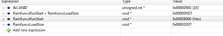

I found the following issue:
In my command file:
           GROUP
            ramfuncs
            .TI.ramfunc
                }LOAD = FLASHcode,
                         RUN = RAMDfunct,
                         LOAD_START(_RamfuncsLoadStart),
                         LOAD_SIZE(_RamfuncsLoadSize),
                         LOAD_END(_RamfuncsLoadEnd),
                         RUN_START(_RamfuncsRunStart),
                         RUN_SIZE(_RamfuncsRunSize),
                         RUN_END(_RamfuncsRunEnd),
                         PAGE = 0, ALIGN(4)
If there is not sufficient room in RAMDfunct global variables are overwritten:
If you can see RamfuncsRunStart + RamfuncsLoadSize is past the first global variable CANID.
Increasing RAMDfunct solved it.
From .map file
abs   0000164a  _Cla1funcsLoadSize
abs   000020d7  _RamfuncsLoadSize
abs   000020d7  _RamfuncsRunSize
abs   0000b000  _RamfuncsRunStart
abs   0000d0d7  _RamfuncsRunEnd
0000d001     340 (0000d000)     _CANID
An error message should be nice.
