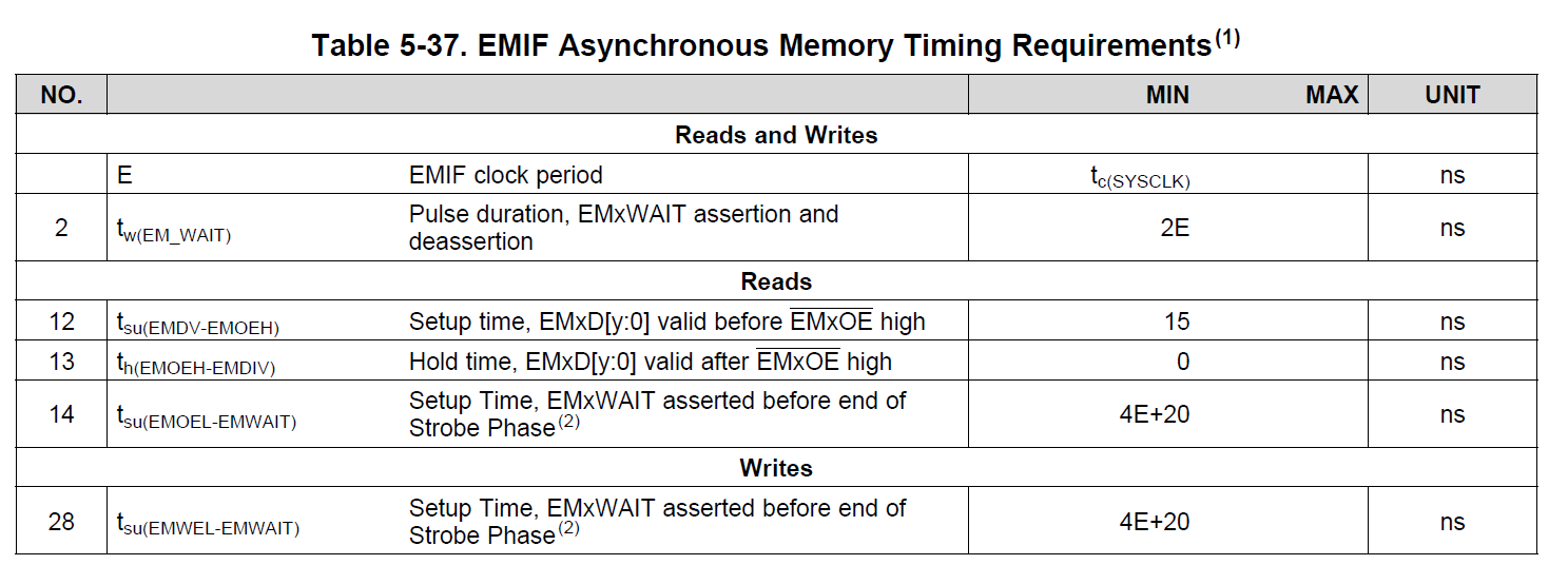

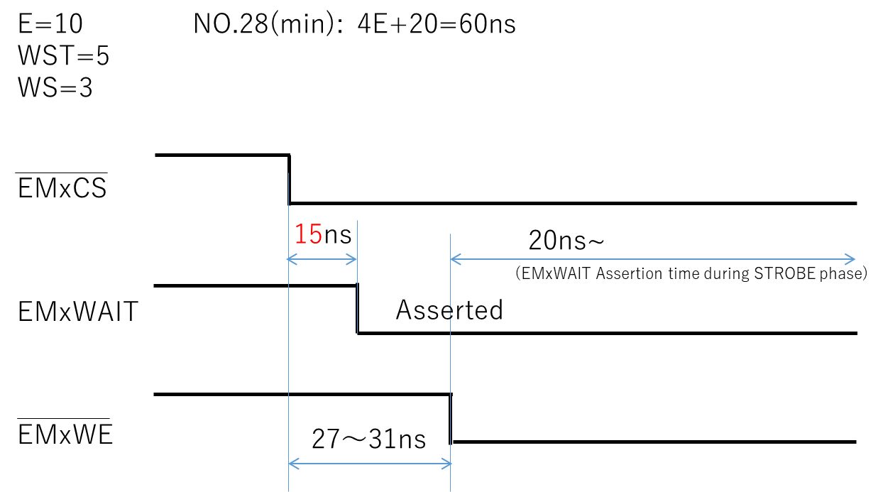

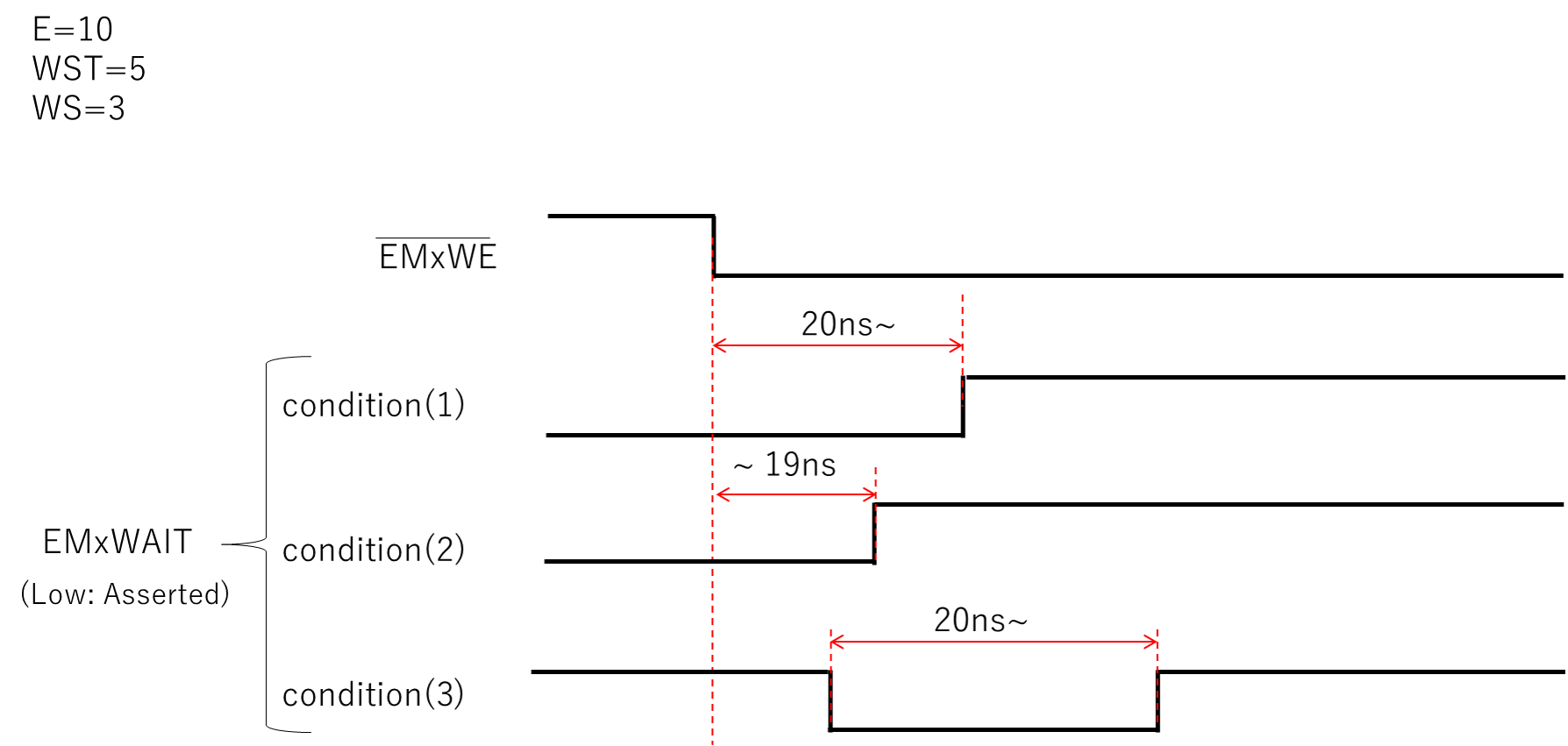

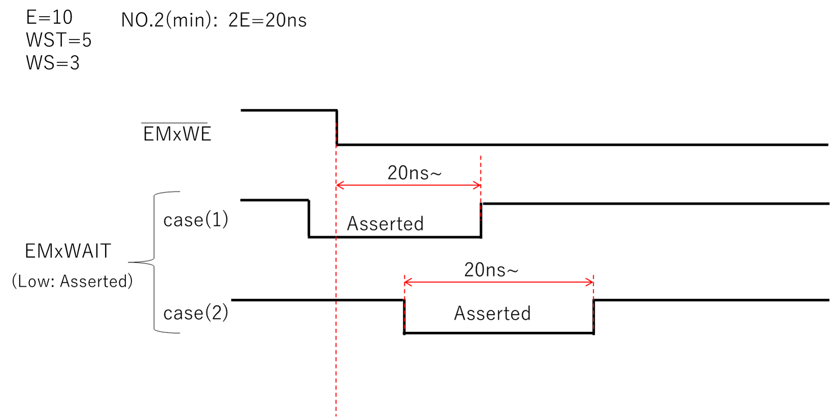

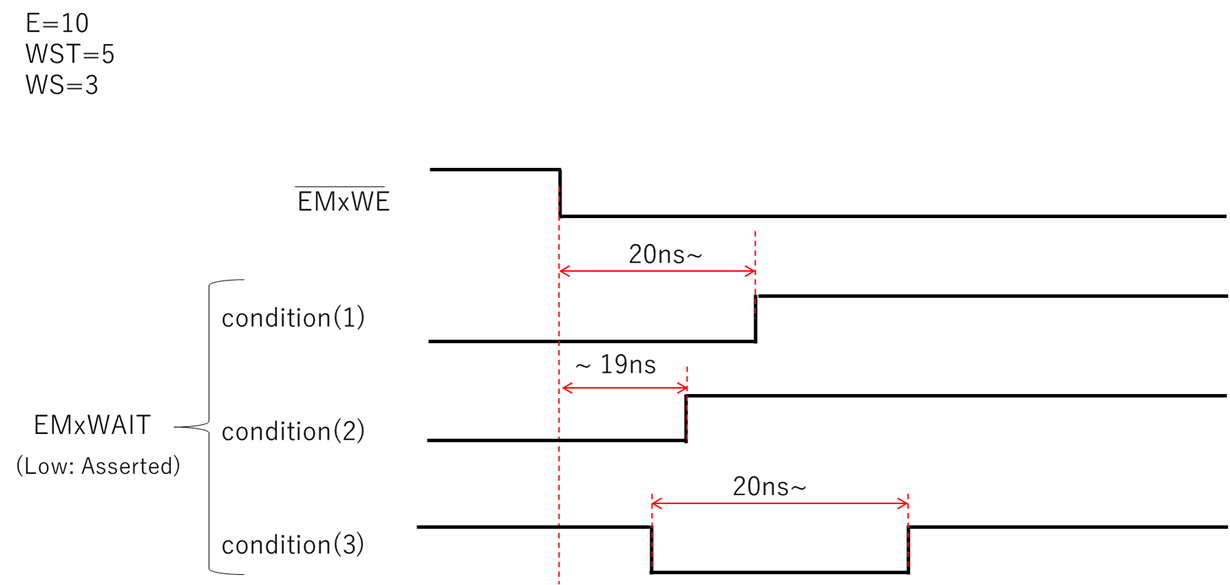

In a case of Extend Wait mode (ASYNC_CS2_CR[30](EW) = 1),
will extended wait cycles be inserted under the follwing conditions?
Althought we implemented under the condition (1),
the extended wait cycles were actually inserted.
Hi Vivek,
Thank you for your reply.
I want to know following two points.
(1) In following cases, Timing Requirement NO.2(Table 5-37) is fulfilled?
(Is it all right if EMxWAIT is asserted before STROBE phase?)
(2) In a following case, Timing Requirement NO.28(Table 5-37) is fulfilled?
(Is it guaranteed that extended wait cycles will be inserted?)
