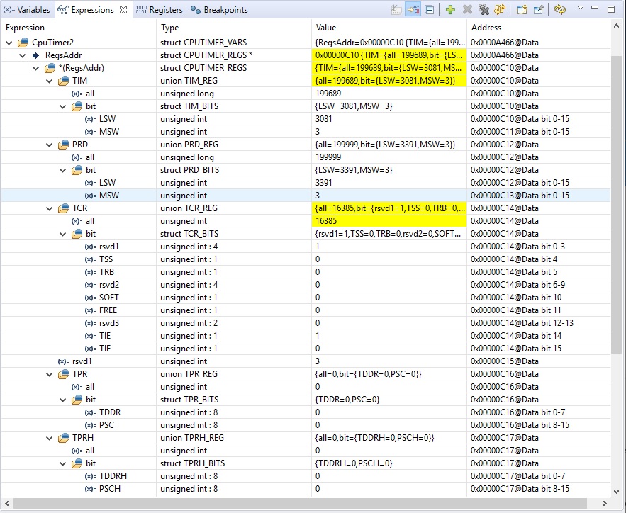

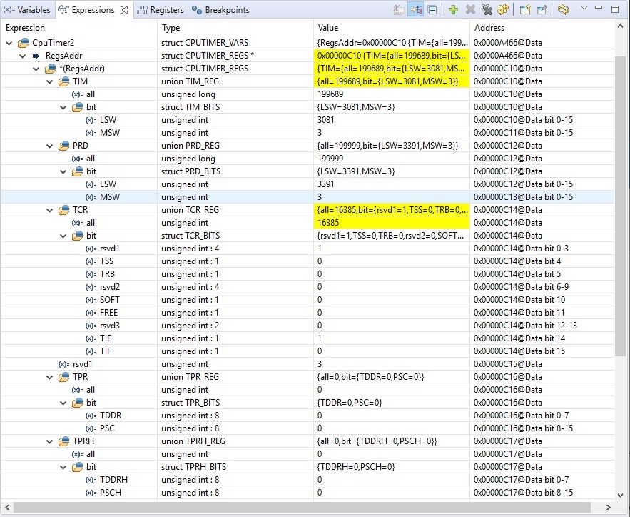

  • Ken-
    Here are the Timer2 register values when the interrupt fires.  Looks like I was incorrect initially...the TIM has only counted down by ~300 counts instead of ~3000.

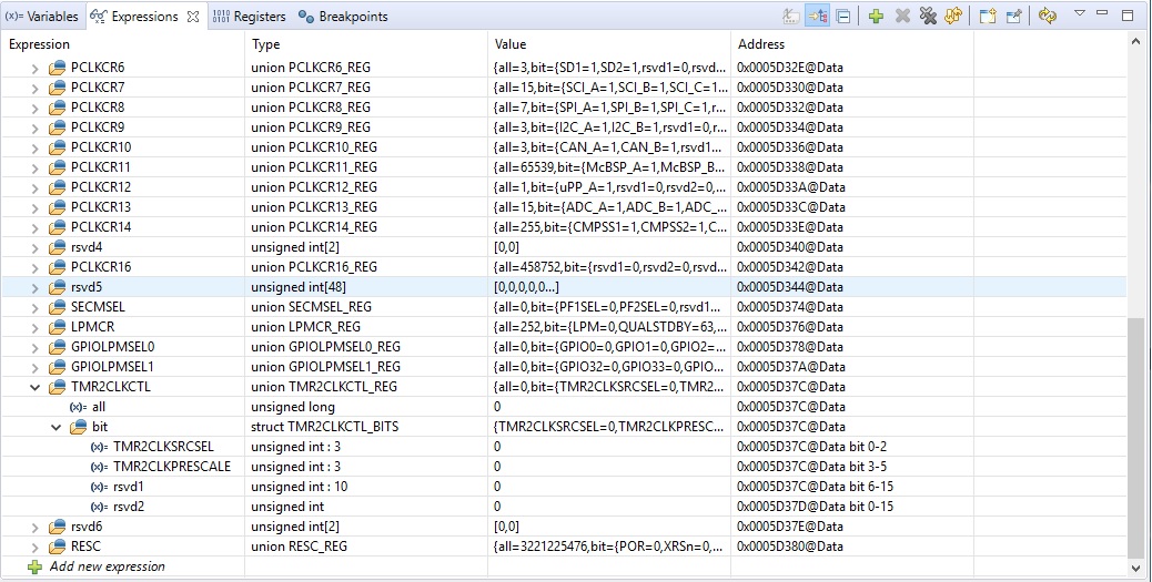

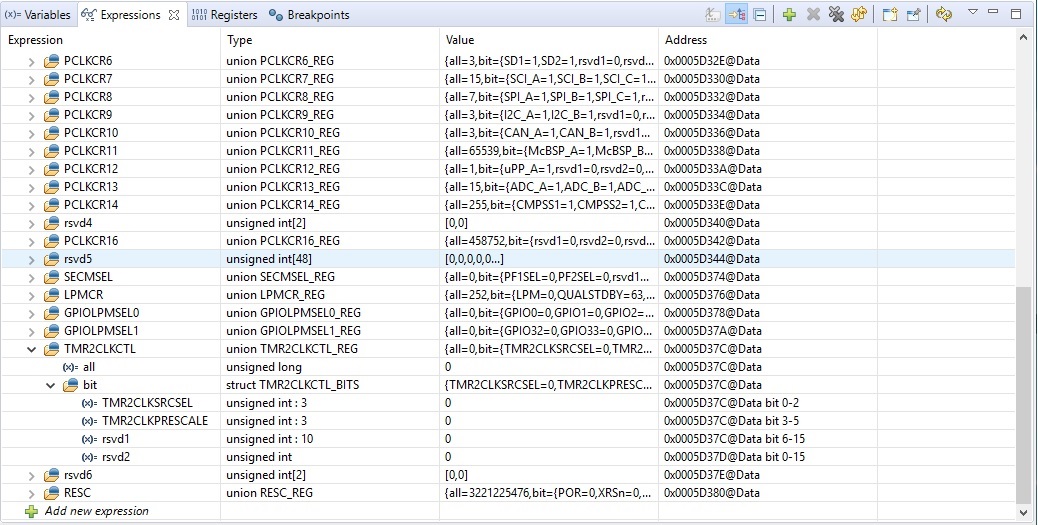

  • Hi Chris,
    What is the frequency of SYSCLK? Did you configure the PLL to 200MHz and use it as a SYSCLK? Also, what is the configuration of TMR2CLKCTL register, can you please provide snapshot of that as well?
    Nirav
  • Hi Nirav-
    SYSCLK should be 200MHz and use the PLL, I believe.  I think this is done with a call to InitSysCtrl() earlier in main().  Sorry...I'm less familiar with the clock configuration code.  TMR2CLKCTRL looks to be 0:
  • Hi Chris,
    All the configurations looks good. And based on the values read, it appears that interrupt should not have occurred as the Timer2 is still counting down.
