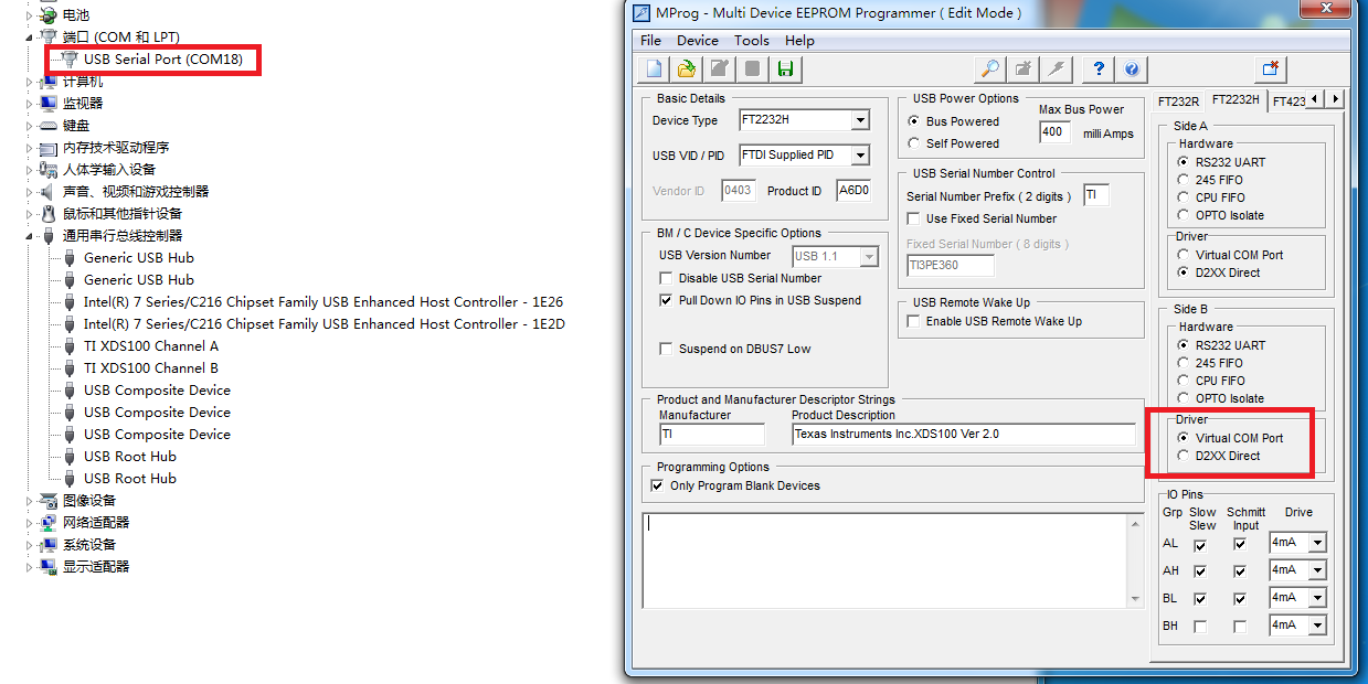

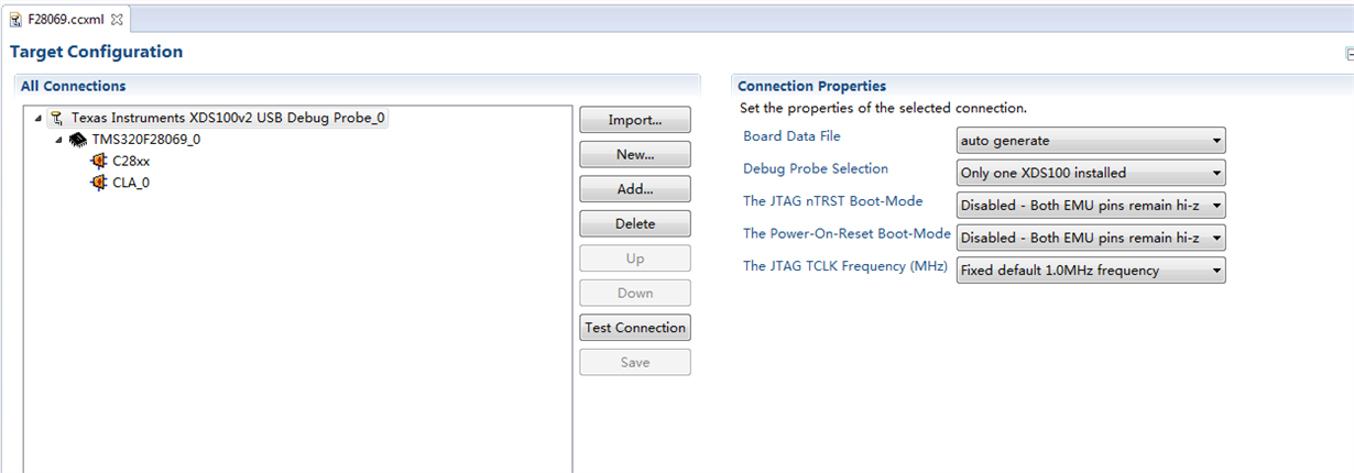

Hi, guys, I have a problem about XDS100V2 on the LAUNCHXL_F28069M. first, I bought it from TI, and I provide the USB power, and the two green LED light. the switch set is the same as the factory board. and the .ccxml file is right I copy at the below. see the below picture.
and I still have the problem in CCS about XDS100v2 emulator. see the log, would you please help me to find the solve way? thanks.
