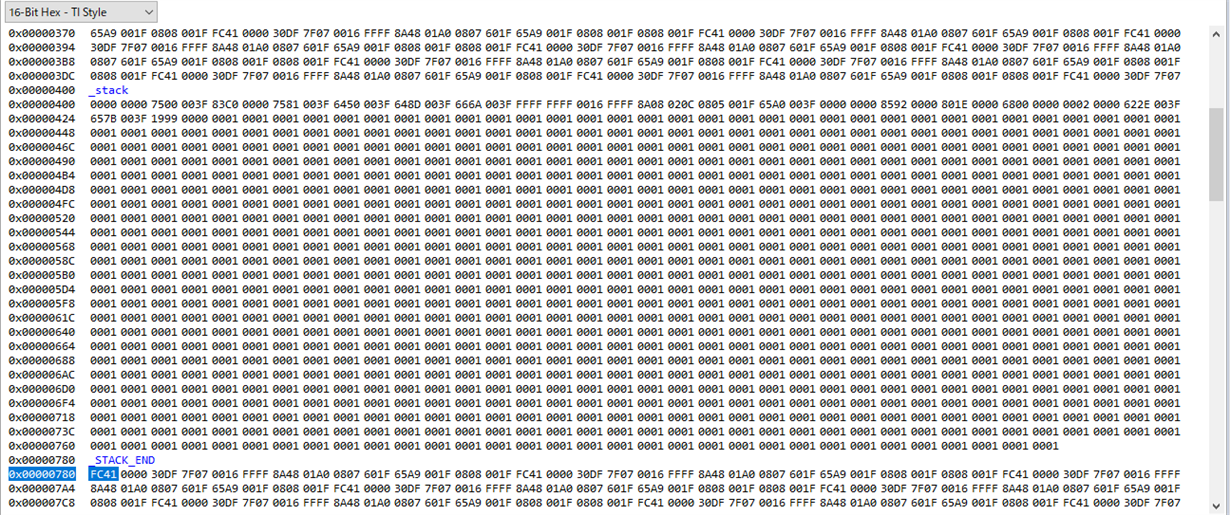

  • I  fill 0001 in stack(0x00000400~0x00000780) and start operating.
    When the amount of interrupts are 4,
    the stack data change from 0x00000400 to 0x00000428.
    Another data don't change.
    But when the amount of interrupts are 5,
    not only all stack data change but also another data change.
    At default,I think stack memory is 0x000400 ~ 0x00780 by the following code in CMD file.
    (I can't understand not 0x00800 but 0x00780)
    PAGE1:
     RAMM1 :origin=0x000400,length=0x00400
    .stack :>RAMM1, PAGE=1
    If RAMM length is longer,is this problem settled?
  • Yeah, that looks like stack overflow. Try making your stack bigger in your compiler options (you'll probably need to move .stack to a bigger RAM block too in your cmd file). It is a little concerning that the difference in stack usage would be so dramatic though with just 1 extra interrupt enabled. Do you have a lot of local variables? A lot of nested function calls? Printfs?
    It is okay if your stack doesn't take up the entire RAM block. That just means that space can be used by the linker for other stuff.
    Whitney

  • I find the place causing overflow by placing breakpoint.
    The place is Task A1 inside "if ( (*ePWM[1]).TZFLG.bit.OST == 1 )".
     Because of my experiment environment,
     the operation enter "if ( (*ePWM[1]).TZFLG.bit.OST == 1 )".
     If it's improved so as not to enter there,
     overflow don't occur.
    In detail,
    When I set breakpoint to first "asm (" NOP")" and debug start, the code stop at breakpoint and don't overflow.
    But When I set breakpoint to second"asm (" NOP")" and debug start, the code don't stop and stack overflow.
    If the code restart  after debugging set breakpoint to first "asm (" NOP")" , and stopped.
    The code don't stop and stack overflow.
    If the code advance to "DINT" by using stepinto after debugging set breakpoint to first "asm (" NOP")" , and stopped.
    I don't understand why and how improve.
     When I add three XINT, I don't change Task A1 code.
     To operate correctly ,Is there something which should be added?

  • I think I have an answer. In your ISR_Temp() function you add an IRET instead of letting it run to the compiler generated one. You're skipping a NASP which means under certain circumstances your SP is going to be incorrect, leading to an invalid return address.
    I removed the asm(" IRET") and I didn't see the memory being overwritten anymore--the ISR returns properly after executing the NASP. It's still not clear to me what role XINT3 is playing in this though. I don't seem to hit the ISR_Temp() at all when it's in the code. This should at least help you move forward with your debug though.
    Here's more info on the context save and restore if you're interested: processors.wiki.ti.com/.../C28x_Context_Save_and_Restore
    Whitney
  • thank you for your answer.
    I remove "asm(" IRET") " and success.
    Isn't it a problem to remove this?
    This code is wirrten default in controlSUITE.
  • I think it must be a bug in the code from controlSUITE then. Like I said, it can leave the stack pointer incorrectly aligned, leading to a bad context restore.
    Whitney
