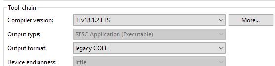

Dear support,
I'm working on LAUNCHXL-F28379D evaluation board.
If my code executes the DELAY_US macro, I get:
ti.sysbios.family.c28.Hwi: line 1022: E_unpluggedInterrupt: Unplugged interrupt flagged: intr# 19
xdc.runtime.Error.raise: terminating execution
#define DELAY_US(A) F28x_usDelay(((((long double) A * 1000.0L) / (long double)CPU_RATE) - 9.0L) / 5.0L)
#define CPU_RATE 10.00L // for a 100MHz CPU clock speed (SYSCLKOUT)

  • The issue was solved after adding "_FLASH" to the predefined symbols.
    Now the below code is active and there is no problem running the F28x_usDelay(x)
    void InitSysCtrl(void)
        // Disable the watchdog
        DisableDog();
    #ifdef _FLASH
        // Copy time critical code and Flash setup code to RAM. This includes the
        // following functions: InitFlash()
        // The  RamfuncsLoadStart, RamfuncsLoadSize, and RamfuncsRunStart
        // symbols are created by the linker. Refer to the device .cmd file.
        memcpy(&RamfuncsRunStart, &RamfuncsLoadStart, (size_t)&RamfuncsLoadSize);
        // Call Flash Initialization to setup flash waitstates. This function must
        // reside in RAM.
        InitFlash();
    #endif
