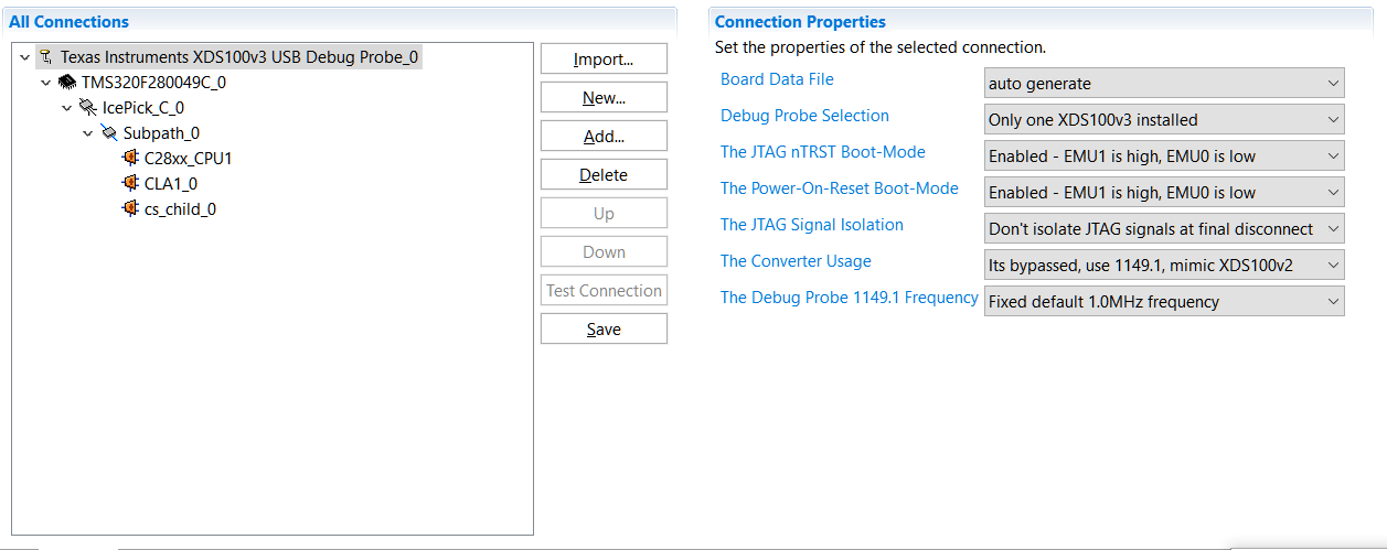

    Since this a fresh unit I'd like to try and hold the device in reset from a CPU exection POV until we can gain control from the emulator.
    If you double clickon your target config(.ccxml file) it will bring up a dialog window.  If you click on the "advanced tab" it will bring up a window like the one attached below.  For both the JTAG nTRST Boot and Power on Reset Boot, from the drop down pick "Enabled EMU1 is high, EMU0 is low" and save it.
    Make sure this is set as your active target as well.
    Power cycle the device(or power up if it was just off this time), and see if you can connect.
    I suspect the device is executing code after it is powered up, but since it is new the flash is all 0xFFFF which is an illegal instruction and there may be a challenge getting emulation control depending on what the CPU is doing.
    Let me know if this allows the emulator to connect.

  • Hi Matthew,
    I tried the settings, but no success. I think I give up with that sample of the board. Others work flawless.
    Thanks for your help
