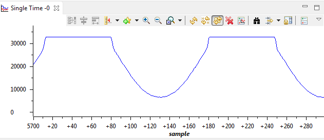

Dear TI members,
I come here to ask two question after struggling for several hours for a couple of days trying to solve this issue by myself. My LAUNCHXL-F28027 says it can handle an input of 0-3.3V, so I am trying to send a signal with Vpp = 3V and Voffset = +1.5V (connected between ADCINA1 and GND in my board), but when I do that, my ADC becomes saturated as if the signal input is going beyond its limitations. Figures of my ports and my ADC output are shown below. Since my ADC is 12bits, I expected that if I send a signal Vhigh = 3.3V and Vlow = 0V, my ADC.RESULT would give me values ranging between 0 and 4095...
Besides the offset problem, I am also struggling with the simple task of adjusting this signal so that it can be sent to "spll1.AC_input" needed for the 1ph PLL function from Solar lib "SPLL_1ph_IQ_FUNC(&spll1);". Supposing that my ADC output signal is ranging from around 6600 to 24000 (when I send Vhigh = 1.5V and Vlow=0V), should I manually add a -15300 to set the signal to +- 8700, or is there a function from IQmath that does that?
I would really appreciate any help with these beginner questions since they are holding me from moving forward with my work.
Thank you,
Victor

    You are correct that the ADC range is 0-3.3V, assuming that the internal BG reference is used. If the source is the same as the above this is true.
    For the graph of the ADC output, can you look at the properties and determine which variable is being monitored and find in the code where that is calculated? I'd like to make sure that it is not the calculation that is saturating vs the ADC output saturating. Another way to do this would be to look at the ADC Result register that corresponds to this value and see if it is at 4095 as well.
    The above will help me determine the direction to take this debug.

  • Dear Matthew,
    I really appreciate your willingness to help. I compared my ADC with the one from the solar project you mentioned, and they seem to match. I have added my Adc.c below:

    I have also created a Uint16 buffer to directly save the values from my ADC. Here are two figures with my Vhigh = 3.3V, Vlow = 0V:
    and with Vhigh = 2V, Vlow=0V:
    Please let me know if there is any other information I could share to help.

    I beleive I know the issue with the ADC Result saturation, so I'll address it now and come back for the SPLL after I've had more time to look at it.
    Since you are resetting the ADC at the top of your ADC Init, there are some calibration values that are stored in the ADC registers that are getting reset as well. Normally the Device_Cal() routine is called a part of the main system init early in the .main; but since you are resetting the ADC you'll need to call this function again, after the reset has been issued.
    This should already be defined in your code elsewhere so you should be able to add this:
    (*Device_cal)();
    and it will work. I would do this after your NOPs and before you power up the ADC.
    Note that if you reset the ADC again you'll have to repeat this step.

    Dear Matthew,
    I included the (*Device_cal)(); in my code as suggested:
    AdcRegs.ADCCTL1.bit.RESET = 1;		// Reset the ADC
    	asm(" NOP");
    	asm(" NOP");
    (*Device_cal)();
    And then I received an error that Device_cal wasn't defined. A quick search led me to add this define to my code:
    #define Device_cal (void(*)(void))0x3D7C80
    But my ADC is still saturating early. I tried moving the Device_cal function around inside the Adc.c or in the main.c, but nothing changed. The image below is my ADC with a vhigh=1.8V and vlow = 0v:
    Maybe I didn't define Device_cal properly for this device?
    Victor

    It looks like this did push down the offset somewhat from before. After you run the DeviceCal can you read back the below two ADC space registers and report back the values
    AdcRegs.ADCREFTRIM .all
    AdcRegs.ADCOFFTRIM .all
    From the code it looks like you are sampling ADCINA1 and ADCINA3. Is there voltage present on any of the other ADC channels even though you are not sampling them?
    Assuming the above graph is plotting ADCINA1, can you comment what voltage(s) are being applied to ADCINA3 during the same time frame?
    Matthew
  • Dear Matthew,
    The values of the registers before AND after the Device_cal are:
    AdcRegs.ADCREFTRIM .all = 9589 (decimal) = 10010101110101
    AdcRegs.ADCOFFTRIM .all = 504 (decimal) = 111111000
    The values go to 0 when I reset the ADC, but then back to these values above once I call Device_cal (these values were there before the reset; they were being set inside InitSysCntrl, but that was being called before the Init_Adc). I have a signal generator giving me a Vhigh=2V connected to ADCINA1 and a Vlow=0V connected to GND. There is nothing connected to ADCINA3.
    One interesting thing that I observe is that ADCINA3 is always zero. The ADC is not even capturing noise (ADCRESULT3 is always zero). However, if I connect my Vhigh to ADCIN3 in my launchpad, I do get a value in my ADCRESULT1, which saturates earlier, at V=1.6V. I suppose the signal should not be propagading between the ADCIN inputs like this?
    Victor

    Yes, a voltage on one ADC pin should not effect another ADC pin. I'm curious about the signal generator terminals called Vhigh and Vlow and how they are working. Most signal generators I have seen just have a BNC out with the signal and ground of the generator coming out. Do you have the model number of the signal generator? I've had issues myself where the signal nominally is about ground so it goes negative; whereas our coverter only takes in positive voltages.
    Another thought is some signal gen's expect some amount of termination(usually 50ohms), without it you will see effectively double of what you expect based on the programmed values. This may be the issue since an overvoltage on an ADC pin, will cause it to effect other channels since it is reverse biasing the CMOS switch. You may want to verify with a scope that what you want the function generator to output is really what you are getting on the pin.
    Matthew
  • Dear Matthew,
    I am happy to say that the issue at this point was the signal generator. Now my PLL also works properly! Thank you for your assistance. I would never have realized that the system needed to be calibrated once again after my InitADC().
    Victor
