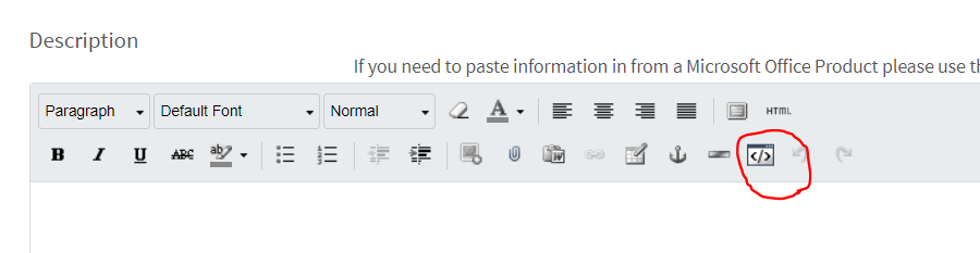

  • Not sure if we have the entire text related to your post, since the entire post appears as a large image. In future, please type your questions and not attach it as an image. Also, if you insert a code snippet in your post, always paste it using the “Syntax Highlighter” option. That makes the code easier to read. I have requested a PWM expert to look into your issue.
