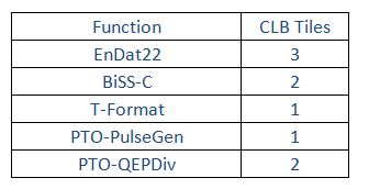

  • Hello All,
    Just to give customer an idea of what can be done concurrently on a given device please find below how many CLB tiles each encoder standard typically takes.
    So in the current libraries:

    Note that there are only 4 CLB tiles, and connected resources are limited as shown in the library user guide of each of these functions.

    Yes. But some combinations like EnDat22 + PTO (QepDiv) may not be possible as there are not enough CLB resources.
    Note the number of CLB tiles used for each function in the table above. And note that there are only 4 CLB tiles - so the maximum functions you can develop will depend on the available resources and the resources consumed by corresponding functions.
