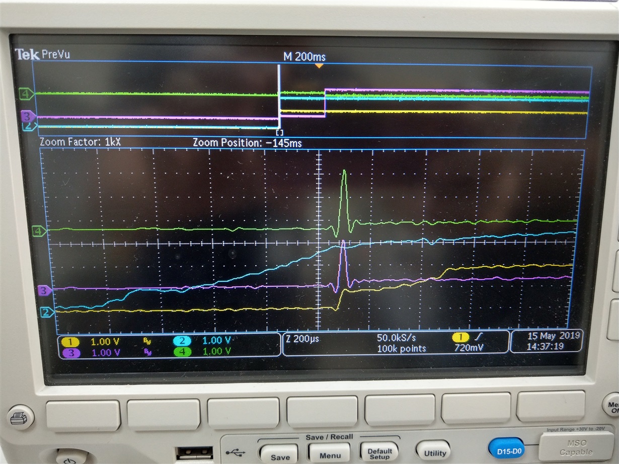

TMS320F2812: F2812 PWM glitch during power-on-reset
Part Number: TMS320F2812
Some of my customer's product , F2812 has the PWM glitch during power on reset.
The PWM glitch happens randomly  with each PWM pin and it may happen with PWM pair at the same time.
The situation maybe cause the IGBT short.
I have found similar issue on TI e2e, e2e.ti.com/.../380559
And give the same solution, but still fail.
The PWM glitch always happen when 1.9V on as below picture..
Any suggestion to solve it ?
ch1:1.9V  , ch2:3.3V, ch3:PWM5, ch4:PWM6
best regards,
