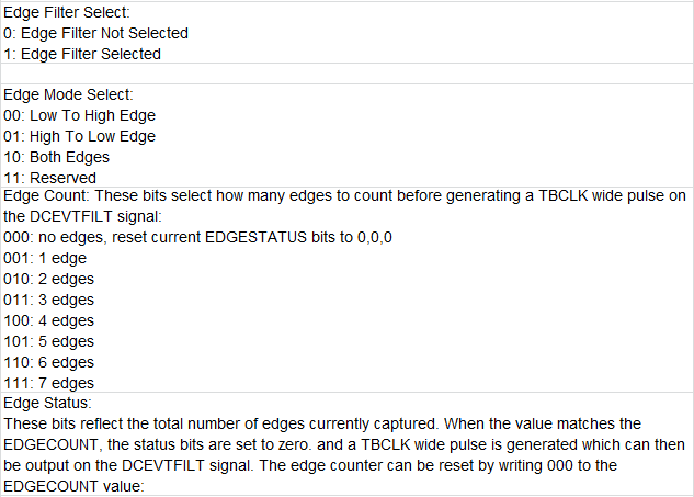

2. There are no description for EDGESTATUS,EDGEMODE,EDGEFILTSEL fieled in DCFCTLregister.
Can you please describe the meaning for those value?
