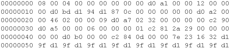

I want to have a binary image of my flash. So, I try to use HEX200 with binary option. My command is:
c:\Tools\AH-Applications\ti\ccsv8\tools\compiler\ti-cgt-c2000_18.1.1.LTS\bin\hex2000.exe -b -o ECU_Load.bin ECU_Load.out ..\_link_cmd\ECU_Load_bin.cmd
My command file is:
--issue_remarks
--binary
--zero
--image
--fill=0xFF
--romwidth=8
--memwidth=8
--map=ECU_Load_bin.map
ROMS { APPLICATION_BINARY: org = 0x18000, len = 0x3E00 }
SECTIONS
.TI.crctab:
AppliDescrFile:
.cinit :
.text :
.TI.ramfunc
.econst :
I have generate also an hex file without problem.
The fist bytes of the hex ouput are :
The fist byte of the bin output are:
As you can see, the 10th byte (and lot of other) is wrong in the bin file.
Do you know why and can you help me.
