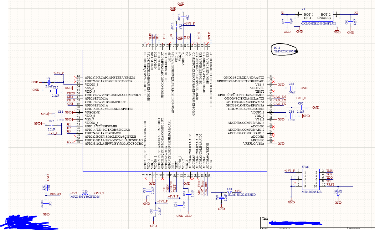

All work fine, compile ok. I've "test.out" binary ready to be loaded into MCU. I would use standard JTAG connection and made this schematic:

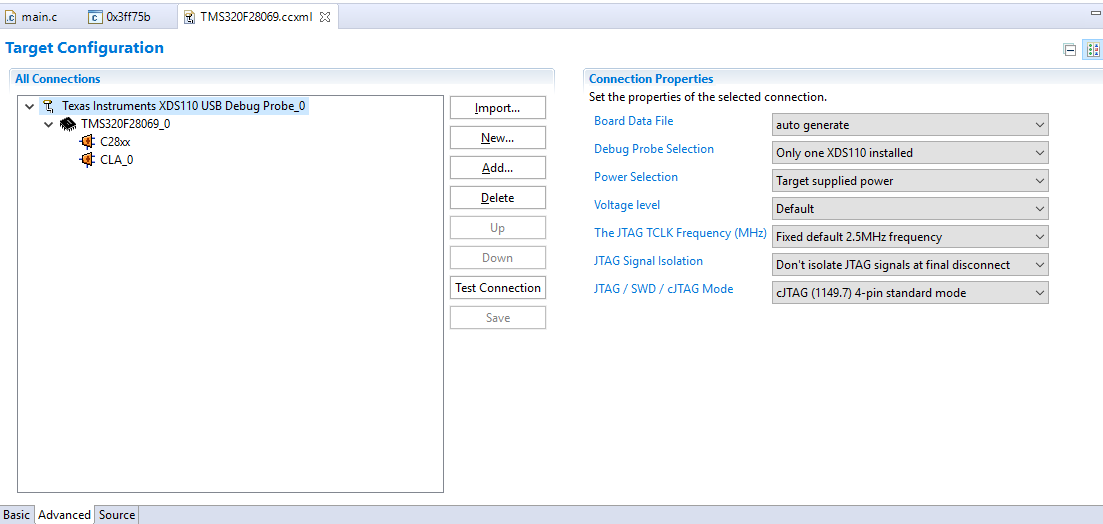

This is my "ccxml" configuration:
If i click "Test Connection" all seems to be fine:

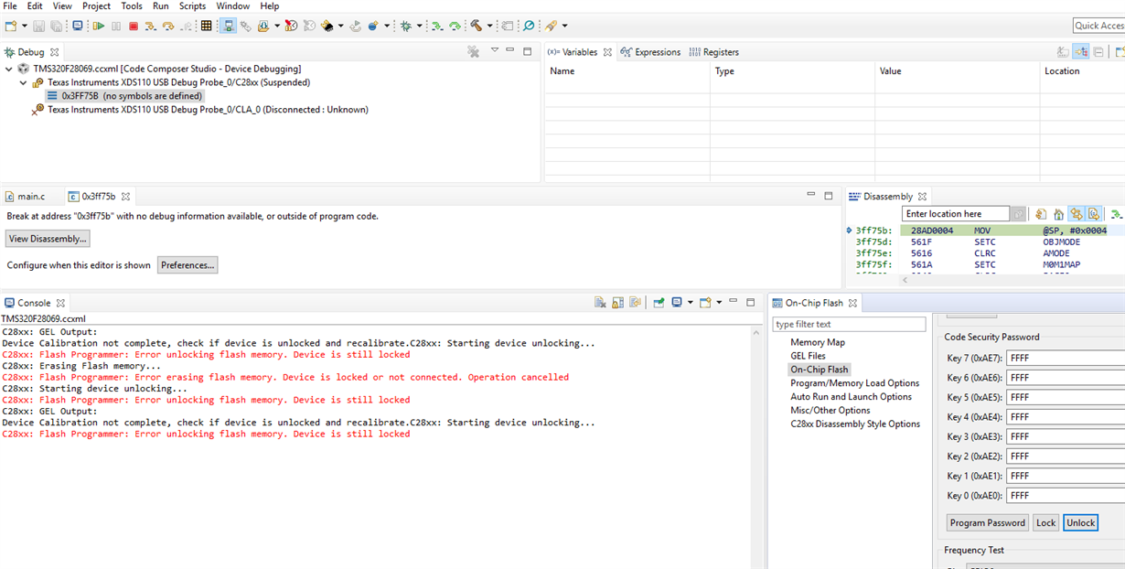

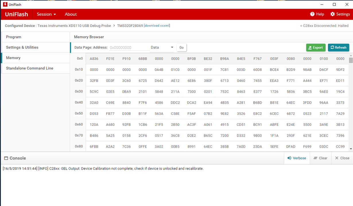

...I can read memory from MCU and dump it to file:
...but I've a warning about "Device Calibration".
If I try to enter debug session I can connect to MCU and view status but when I try to debug/donwload the code CCS send the error: C18xx: Flash programmer: Error unlocking flash memory. Device is still locked. MCU can not be unlocked and erased. The key pass is all set to 0xFFFF.

  • I try to program it with XDS110 (from Launchpad F280049C).
    The above is not clear. Are you using the JTAG circuitry on the 280049 Launchpad and physically connecting it to your 28069 board? Or are you saying you copied the XDS110 circuitry from the 280049 Launchpad and used it on your 28069 board? I presume it is the latter.
    When you connected to the device using CCS, did you examine the password locations in flash to verify they contain 0xFFFF?
    Have you looked at www.ti.com/.../spracf0.pdf ?
  • Hi Hareesh,
    thx for the support. The XDS working fine. I can program/debug other custom PCBs with other TI MCUs.
    I don't understand what's happening to my TMS320F28069M.
    I checked the password locations area and it's all 0x0000. :-(
    I changeed the MCU with new one, then I tryed to program only once and now I have all 0x0000 again.
    What is happening? Are there any conditions that cause MCU auto-lock by itself? Should I look in some initialization files (*.cmd, *.gel)?
  • Stefano,
    It looks like there is an error in your schematic, pin VDD3VFL is not powered. This is the flash power pin and should be ganged with the VDDIO supply(3V3_F in your schematic).
    There is a decouping cap to ground, so it shouldn't be too hard to jump a wire from C90 to C86 to get this at the correct voltage. I'd go ahead and replace the 100nF with the same 2.2uF you have on the other power pins as well.
    This would explain why the flash is "locked" since it is reading back all 0x0000. Device Cal is located in OTP, which is also powered from this pin.
    Matthew
  • Wow, thx Matthew.
    Really good bedug! Now I try your solution and then update the forum.
