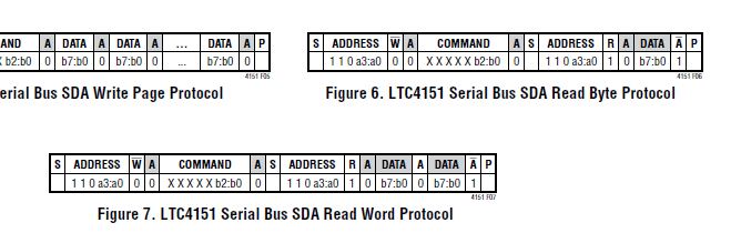

Hello dear colleagues.
I am trying to learn the I2C module but the examples below the driverlib was complex for me. Can someone share a basic I2C example(Read/Write operation) without interrupt?

  • Hi Mohammad,
    Can you share your I2C config and write/read function code that's giving issues?

  • According to LT4151 datasheet
    So. According to my connections my slave address is 0xCE but when I send the second start command I have to send 0xCF. Still somethings are not right :\
  • I think this table is treating the R/W bit like the 0th bit of the address. With our hardware though, the R/W bit will be configured by the I2C module based off of whether or not you're in I2C_MASTER_SEND_MODE or I2C_MASTER_RECEIVE_MODE. So when you program the slave address in the slave address register use the hex value in the table right shifted by one--so (0xCE >> 1) or 0x67.
    Whitney

  • I resolved my issue by changing the clock of the I2C module to 380khz %50 duty cycle but I really dont undertand why it didnt work with 400khz and %33 duty cycle. According to my calculation it has to work. Because in f280049C datasheet says
    SCLLOW minimum -->1.3us
    SCLHIGH minimum --> 0.6us
    According to my calculation 400khz with %33 duty
    SCLLOW --> 1.6us
    SCLHIGH --> 0.82us
    For 380khz %50 duty (This one works)
    SCLLOW --> 1.3us
    SCLHIGH --> 1.3us
    Can you explain to me what the real problem is? The picture below is from LTC4151 datasheet.
  • I couldn't say off the top of my head what would cause this. I agree that you appear to be meeting the minimum required high/low timings based on your calculation. Did you look at the waveforms on an oscilloscope/logic analyzer to confirm that the actual signal matched your calculations? Did you check the other required minimum timings?
    Whitney
