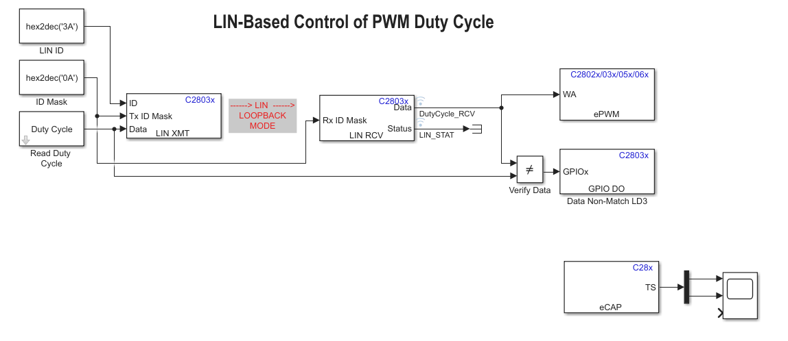

you have linked the correct documentation page. Looking at that page it does seem like TS should be the correct output to observe.
How have you configured the eCAP?
I would suggest looking how this example sets up the eCAP and working from there. https://www.mathworks.com/help/supportpkg/texasinstrumentsc2000/ug/permanent-magnet-synchronous-motor-field-oriented-control.html

Since I am using the eCAP simulink block. I have set the operating mode to eCAP and you can see the settings of block in the images below:
I want for the signal that is high the value stores in Capture event 1 and for low time the counter value stores in event 2 and it remains continuous.
Mohsin

i tried building an example and had the same issue as you. My scope wouldn't display the desired value. Additionally, when looking at the diagnostics window I had a warning about code size.
To correct this error I changed my parameter behavior to inline.
As soon as I did that the warning went away and the scope started working as expected.
This is about the extent of my knowledge in Simulink software, if this doesn't help i would suggest that you contact Mathworks support.
