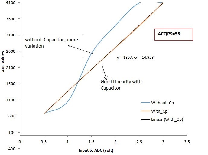

  • Thank you for your answer
    As per your answer , I have worked on ADC
              Test No 1. by using Op-amp buffer amplifier (with capacitor and without capacitor at ADC input)
              Test No 2. by changing ACQPS value
    Test No 1.
    Results:
    So As we can see in those results, Readings are good if I use capacitor across ADC and also we can notice one more thing that If I don't use capacitor ADC values are more than what is expected
    1. Why ADC values are reading more if I don't use capacitor?
    2. What is the use of capacitor at ADC input and how it helps in ADC?
    3. If sample window (ACQPS)  value is 15 for my application, What happens to ADC values if I keep ACQPS value more than 15 (say 20 or 50)?
    I have these questions in my mind?
  • continuation....
    Test No 2: Here is the graphical representation for different ACQPS values .
    So I get good linearity in ADC readings with capacitor. How this capacitor is improving my ADC values
    Now One more trial on ADC
    Test No 3:  Applying input to ADC from 1K ohm potentiometer (with and without capacitor)
    Results:
    As we can see in above readings ,if i use capacitor across input it reads little more value than applied input and if I don't connect capacitor it reads slightly less value. So why it is happening like this
    So finally , I get good ADC values iff  1. I use Op-amp with capacitor     OR     2. I directly use 1K ohm POT to ADC without capacitor
    why this capacitor is playing different role in different conditions?
  • Hi Sangamesh,
    Great job on the thorough investigation!
    One thing to note is that in the case of the op-amp circuit, you might need to be careful driving the large capacitor (100nF) directly; it is quite possible that the op-amp is not stable driving that large of a load. The result of this might be oscillations on top of your DC value. For the op-amp circuit, I'd suggest your start your evaluation with Rs = 30 ohms and Cs = 220pF.
    In the case of the op-amp circuit with no capacitor, the issue is that you switch-in a capacitive load (the internal ADC S+H capacitor) and cause a step-function for the voltage on the op-amp output. It takes quite some time for the op-amp to recover from this. The recommended capacitor when using an op-amp is about 20*Csh; this keeps the step-function voltage on the ADC input pin to less than 1/20 Vin (5%) which prevents the op-amp from having to slew and settle wildly across the full voltage range.
    In the op-amp case you may want to adjust up the S+H time, but sampling rate can be very high.
    As for the charge-sharing case (where you have 100nF on the pin with no op-amp), what is your sampling rate on the pin? If the sampling rate is too fast, the external capacitor will not be sufficiently recharged between samples.
    Overall in the charge-sharing case (large cap, no op-amp) you can use the minimum S+H time, but sampling rate may need to be limited.
