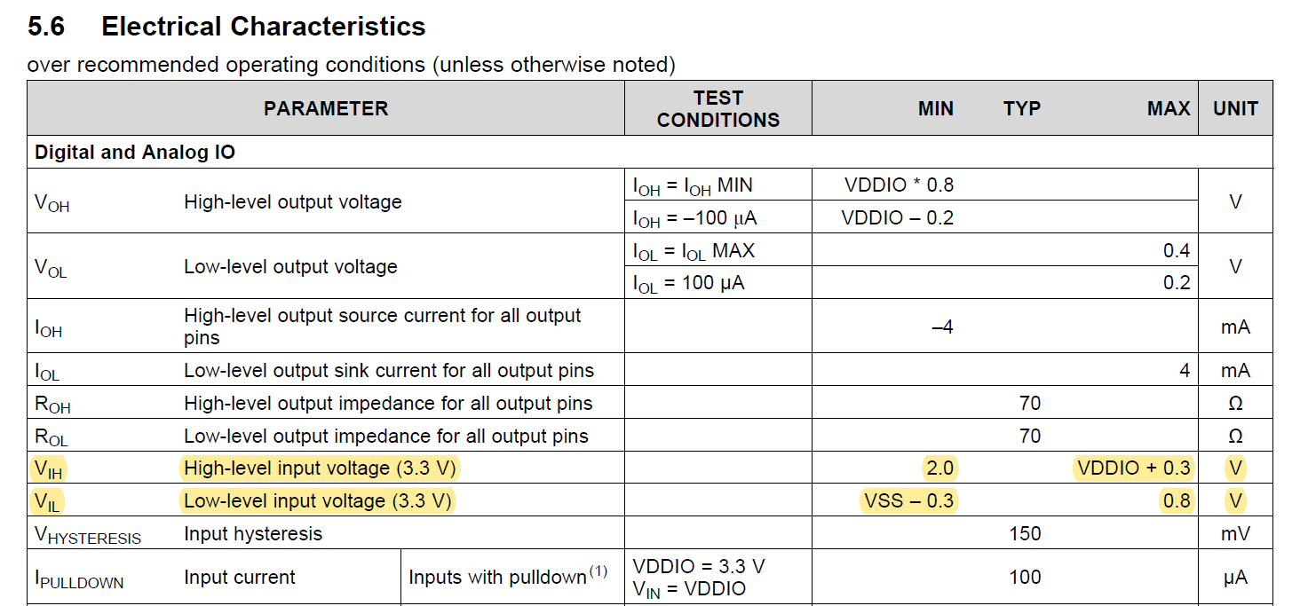

I wonder how can ECAP determine a rising and falling edge.
I get below information form datasheet:

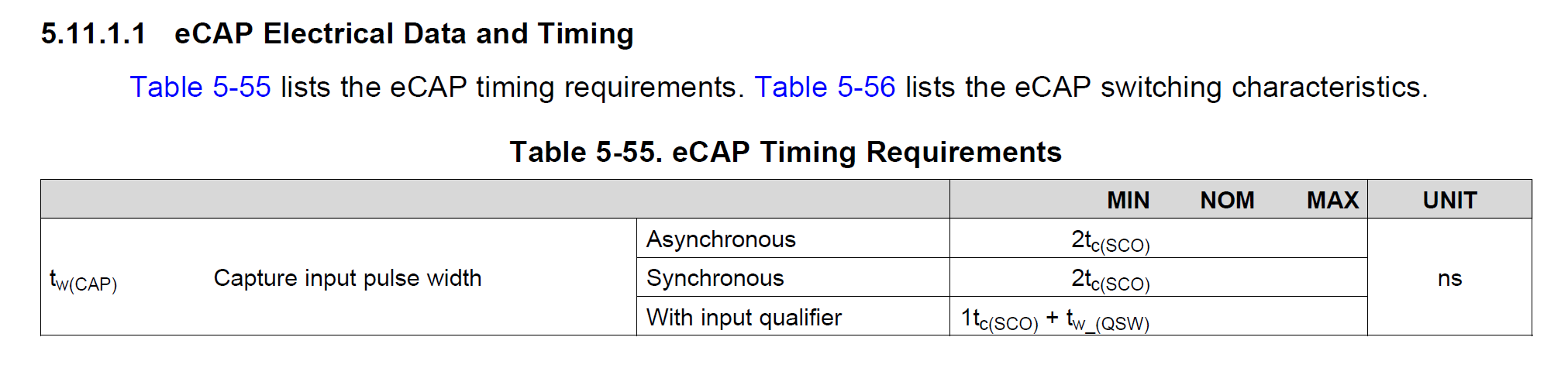

My assumption is a rising edge is determined by voltage changed from VIL to VIH and keep in VIH for 2tc(SCO) long. Does my understanding correct?
BTW, I didn't get any explanation on tc(SCO), what does this clock mean?
