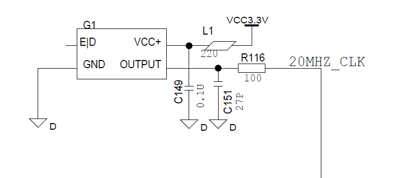

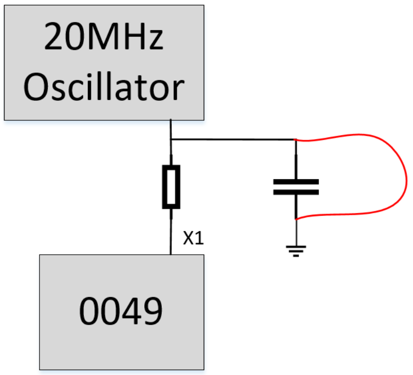

We are facing a question about Crystal oscillator of 0049.
the figure shows how we connect oscillator and c2000,
if we short the Capacitor, our C2000 would enter abnormal states:
  1. enter  Interrupt_defaultHandler
  2. enter NMI interrupt, Flag shows RAM, Flash, CLB have faults
we hope to know, why these two states happened? why NMI didn't show CLK has fault?

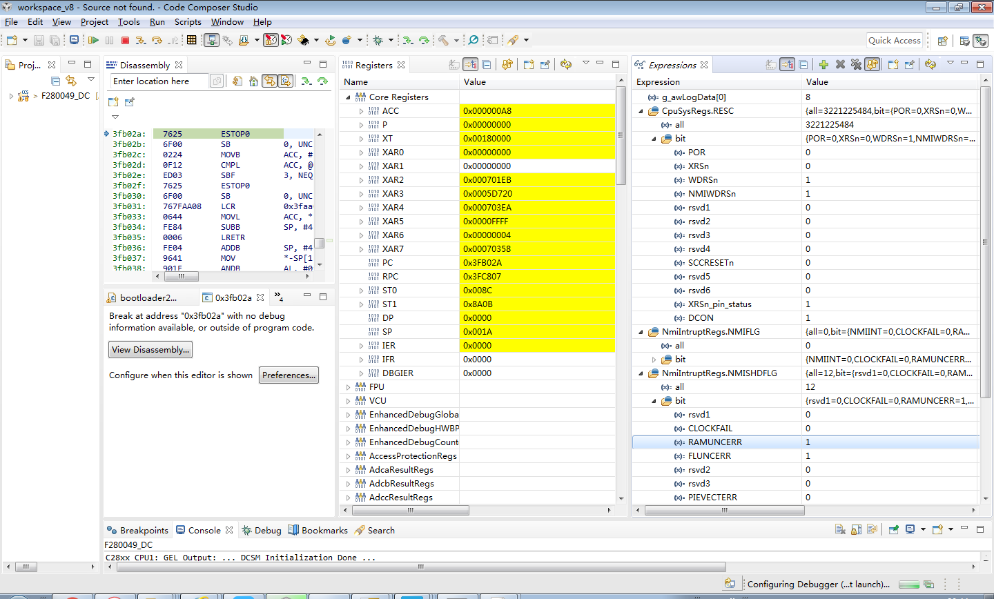

  • HI, We read more register, please see as below:
  • Hi Erwin,
    Based from the register configurations you have sent above, looks like clock is sourced from INTOSC2 (internal oscillator 2) [CLKSRCCTRL1.OSCCLKSRCSEL = 0]. This clock provides 10MHz to the PLL so if customer is shorting the clock input to F280049, device still has a clock, hence not reporting MCDOFF.

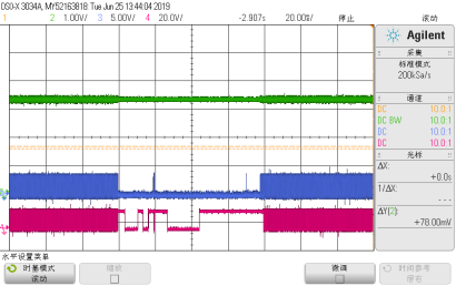

    after oscillator disconnected with Ground, we found PWM1 was high for a long time, it's dangerous for our application.
    this is the waveform:
    Green: XRSN reset signal
    Blue: External oscillator output
    Red: PWM1
    if we do the test with debuger, when we short the oscillator to groud, we found the pointer stop at this address of BOOTROM,
    RPC  0X3FC807
    PC   0X3FB02A
    Our question is,
    why PWM1 will output high level?
    why program stop at this address?
    Thank you
  • Erwin,
    Let's put aside the PWM issue for now. I have a few questions:
    1. Why do you have a capacitor on the output of the oscillator. What is the value of this capacitor?
    2. In my experience, when registers are reading back 0xBAD, it means some power issue is going on. Have you monitored the VDDA/VDDIO and VDD power rails to make sure nothing strange is going on with them? You should also monitor XRSn.
    3. What oscillator are you using? Can you provide a zoomed in scope shot (a few cycles) of the oscillation?

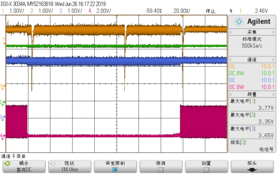

  • hi, Frank,
    Please see my input:
    the frequency is 20MHz, we connect C151 to ground, it's 27pF
    Please see the waveform below, we didn't see any abnormal phenomena
    CH1: XRSN
    CH2: VDDIO C11
    CH3:VDDA C151
    CH4: 20MHz_CLK output

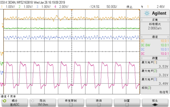

    CH1: XRSN
    CH2: VDDIO C11
    CH3:VDDA C151

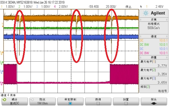

  • Erwin,
    Thanks for providing the extra details. Your oscillator output looks ok. It does have a fair amount of overshoot and undershoot so you might want to look into terminating it properly.
    The more concerning part of the new information you provided is that i see XRSn dipping low a few times. This means the device is getting reset at least 3 times. Is this intentional? Is XRSn being driven externally by something else? I have circled the areas I'm referring to in your capture.
  • hi,Frank,
     XRSn is driven internally.
    Thank you
  • Erwin,
    Ok. If XRSn is driven internally, this means it's coming from the device. This could either be power related or the watchdog is not being handled. For debug purposes, can you make sure the watchdog is disabled?
