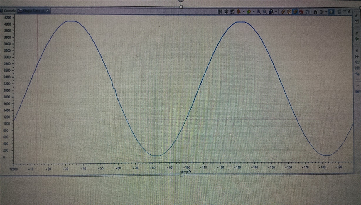

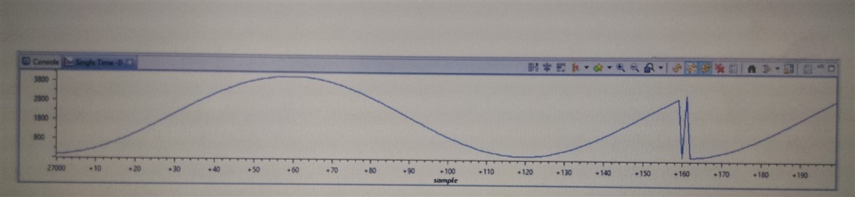

I'm traying to sample a current signal but I have a problem with the sample, the sample frequency is a 12kHz from the ePMW2 and the current signal is 60Hz, the next figure shown the signal sampled and the second figure is of a signal current of 65Hz and the signal of 65 Hz is distorted, I'm using a circular buffer . Could you tell me why is happen?. The code is below.
Second Figure

    AdcRegs.ADCMAXCONV.all = 0xB;
// bit 15-7      0's:    reserved
// bit 6-4       000:    MAX_CONV2 value
// bit 3-0       0000:   MAX_CONV1 value (0 means 1 conversion)

    AdcRegs.ADCTRL2.all = 0x0900;

    EPwm2Regs.TBPRD = ADC_SAMPLE_PERIOD;    // Set timer period  //12449
    EPwm2Regs.TBPHS.half.TBPHS = 0x0000;    // Set timer phase
    EPwm2Regs.ETPS.all = 0x0100;            // Configure SOCA

    Current signal of 60Hz
    second figure 65Hz
