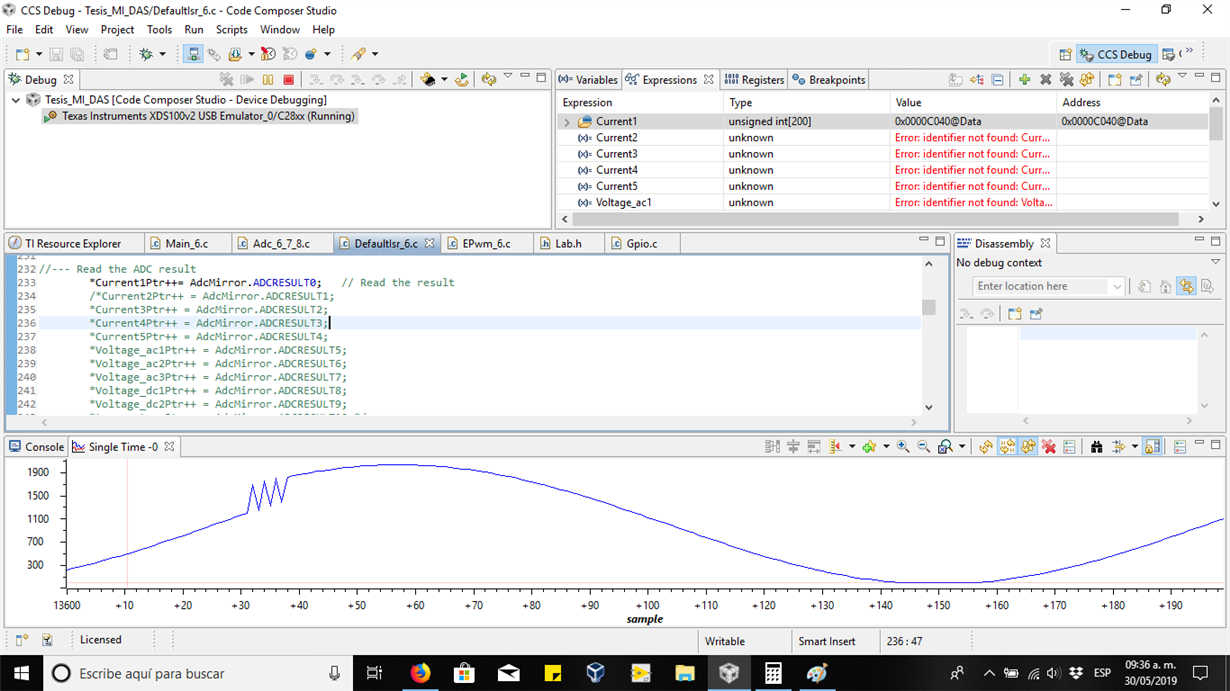

I'm traying to sample a current signal but I have a problem with the sample, the sample frequency is a 12kHz from the ePMW2 and the current signal is 60Hz, the next figure shown the signal sampled and the second figure is of a signal current of 65Hz and the signal of 65 Hz is distorted, I'm using a 200 data circular buffer

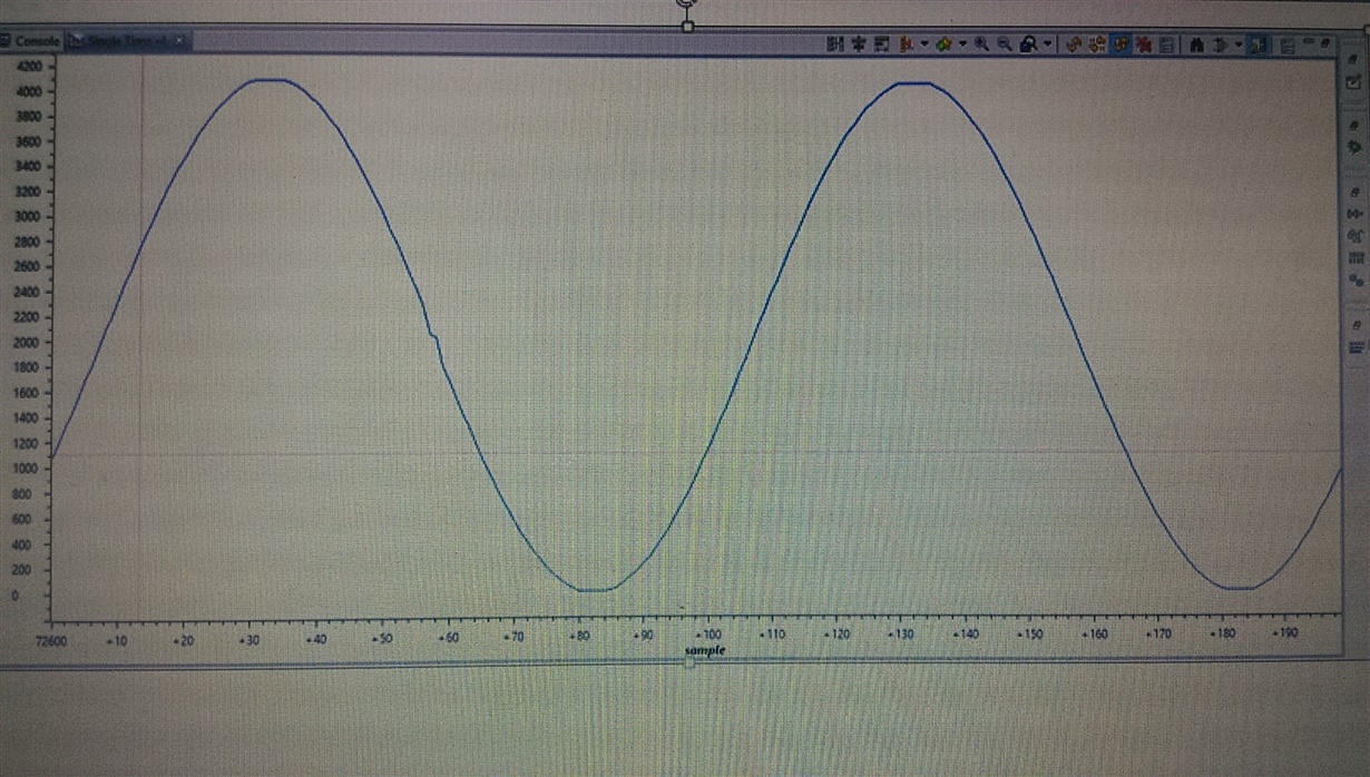

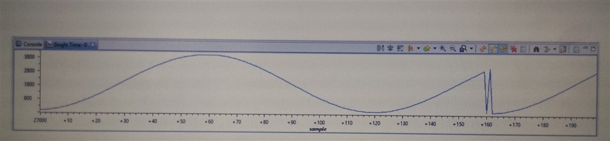

. Could you tell me why is happen?. The code is below.
Current signal of 60Hz
Current signal of 65Hz

  • Tommy,
    yes, I'm using the same program and also use the function generator, I only change the frequency while the program is running, the distortion doesn´t exist if the frequency is a multiple of 60Hz (for example, 60Hz, 120Hz, 180Hz...)

  • Tommy,
    With distortion I mean that the signal is cut off as seen in the second figure above, when the signal is multiple of 60Hz it works right but if the signal is not multiple of 60 60Hz those disturbances appear, when I configure the generator with signal of dc, the signal appears correctly ,there is not irregularities.
  • Juan,
    Based on the nature of the disturbance, I would recommend performing some additional system checks.
    Have you tried setting a breakpoint when the buffer is full and analyzing the static data?
    Can you check the input signal voltage and frequency using an oscilloscope?
    Another good exercise would be to toggle a GPIO pin or record the TBCTR in the ISR to make sure that the ADCRESULT is being read at the expected rate.

  • Juan,
    Thanks for checking. I don't see anything obvious at this point. Does this happen on all ADC channels?
    -Tommy
  • Tommy,
    yes on all the ADC channels, for example the distortion appears on the ADC B channel too, for example you can see in the figure the B0 channel.
  • Juan,
    If it's all channels, I would recommend disabling all logging activity except for a single channel so that you can focus on it. This would also help to check for the possibility of inadvertent clobbering of data due to errors in pointer math.
    -Tommy
  • Tommy,
    disable all channels, except channel A0 and the result with a sinusoidal signal of 65Hz is the one seen in the figure, the same thing happens.
  • Juan,
    Can you attach your simplified program as a file?
    -Tommy

  • Juan,
    Do you see the disturbance on every sweep or does it take some number of iterations or time for it to present itself?
    -Tommy
  • Tommy,
    I see the disturbance in a short time or sometimes in a long time
  • Juan,
    I think you are just seeing artifacts in the graph refresh function through CCS. The continuous refresh of the graph is not guaranteed to operate synchronously with the circular buffer updates so you can see occasional "glitches" in the plot.
    You can confirm this by adding some code in your program to check for real disturbances in the sine wave data series:
    volatile Uint16 halt = 1;
    volatile Uint16 error = 65;
    Uint16 check1, check2;
    if( Current1Ptr == (Current1 + ADC_BUF_LEN) )
        Current1Ptr = Current1;						// Rewind the pointer to the beginning
    else
        if(halt && (Current1Ptr > (Current1 + 2)))
            check1 = *(Current1Ptr-1);
            check2 = *(Current1Ptr-2);
            if(abs(check1-check2) > error)
                asm(" ESTOP0");  // Halt when disturbance is detected in the data series
    -Tommy
  • Tommy,
    Ok, thanks Tommy, You helped me a lot, just one question, why 65 in the error variable?
  • Juan,
    65 was a reasonable threshold value for the disturbance check on my setup. I made it a volatile variable so that it is easy to empirically find a threshold value that works well on your own setup.
    The halt variable is helpful because the circular buffer will lose synchronization with the input signal whenever execution freezes at ESTOP. The buffer will need to flush (with halt=0) before checking for subsequent disturbances.
    -Tommy
  • Thanks for your answers Tommy.
