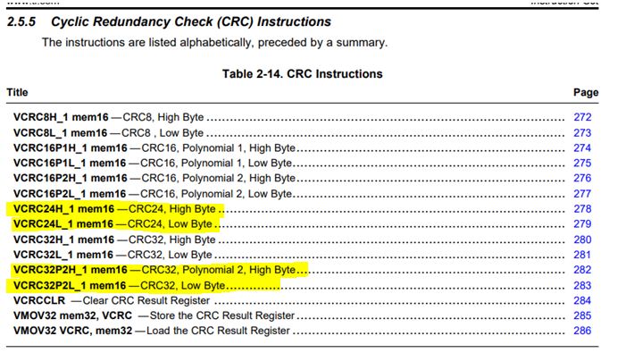

I am trying to understand the Difference between VCU0 and VCU2 in the relation to the CRC calculation.

VCU2 CRC is the same with 2 additions. VCU2 added a 24-bit polynomial and an second 32-bit polynomial.
