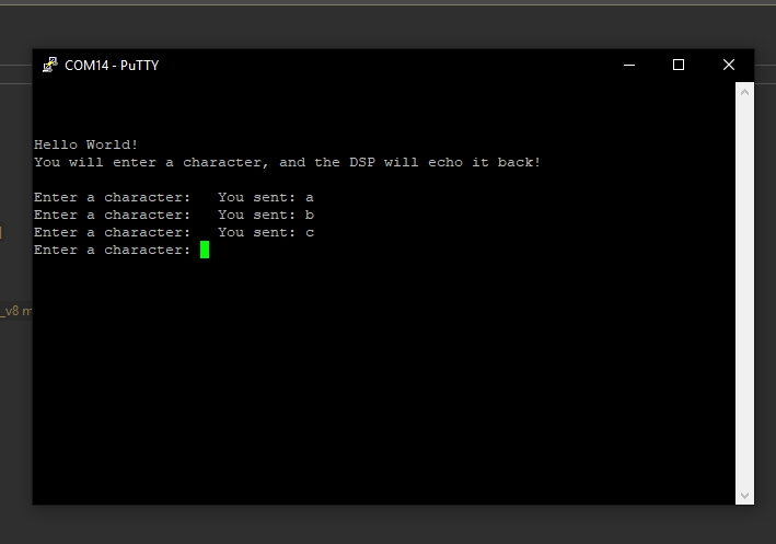

I'm trying to flash F28027 via SCI. I have GPIO34 HIgh, 37 and !TRST LOW. I compiled the kernel with RAM target and blink example with FLASH target.
When I run the serial flash program is seems to freeze after Application Autobaud.
command:
serial_flash_programmer.exe -d f2802x -k kernel.txt -a flash.txt -p COM14 -b 9600 -v
When I debug serial_flash_programmer it hangs on line 384: ReadFile(file, &rcvData, 1, &dwRead, NULL);
Any ideas?
