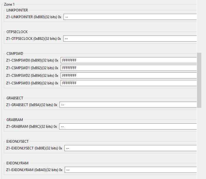

  • I have checked the mention registers and found:
    For the CR Registers
    So it seems the dummy reads are performed and some some password is stored for the Z1 zone.
    And for the RAMSTAT:
    So L0_RAM is secured

  • Hi Jan,
    Zone 1 definitely got programmed somehow. The Linkpointer has been programmed. The default should be 0xFFFFFFFF.
    Yes, it also appears RAM0 is locked to Zone 1 according to the RAMSTAT register.
    Unfortunately, because the Zone 1 link pointer has been programmed to 0xC0000000, you can not reprogram this and point to a new Zone Select Block.
    Therefore, it appears you will need a new part. And try to identify how this part got programmed to prevent it from happening again.
    sal

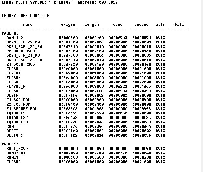

  • Thanks,
    that was also my conclusion, any suggestion to prevent writing to the OTP ?
    The linker map file shows that there are no sections of the OTP are used:
    Jan
  • Hi Jan,
    Maybe you should carefully review the On chip Flash configuration in your CCS Debug session to make sure that you are not populating any of the OTP locations for programming. Start with a new target configuration file(.ccxml) and make sure the Security fields are all left to default. This will ensure that the “On Chip Flash” configuration in your ccxml is not the culprit. I am saying this because this is another way to program security settings to the device. This is my suggestion.
    Also check out this manual (section 6.3) which explains on how to debug the problems with Flash and what all precautions to follow while attempting a Flash Program/Erase operation. I suspect the Flash to be in depletion. Try Depletion recovery option in the On Chip Flash configuration. More details in the link below.
    http://www.ti.com/lit/an/spraal3/spraal3.pdf
    Thanks & Regards
    Pramod
