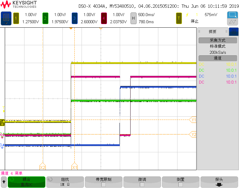

Hello, there is still a question to ask, TMS320F28335 boot pin GPIO84, 85, 86, 87 externally connected to the pull-up resistor 5k ohms, the DSP power-on reset chip completes the reset, that is, the low level becomes high 。The oscilloscope found that the boot pins GPIO84, 85, 86, and 87 all have a low level of nearly 300ms, and then become high, causing the DSP program to fail to load and run. I would like to ask, from the manual, the BOOT pin should be an input when the reset is completed. How can it become a low level when there is a pullup on the outside?
In the figure below, blue is reset and purple is BOOT GPIO85 pin level.
To debug this further, I need the following:
The schematics of your design. You can share this with me privately. No need to post it on e2e. (I will send you a friendship request)
A scope capture that clearly shows the following signals. Please separate the signals on the screen and don’t let them overlap each other:
1.8v, 3.3v, -XRS, GPIO85

The figure you have included shows nothing useful. Unless you send me the schematics that clearly shows all the circuitry related to the 1.8v/3.3v generation, -XRS handling and the scope capture I had requested in my 6/6 5:43 AM post, I cannot help you further. Sorry.
