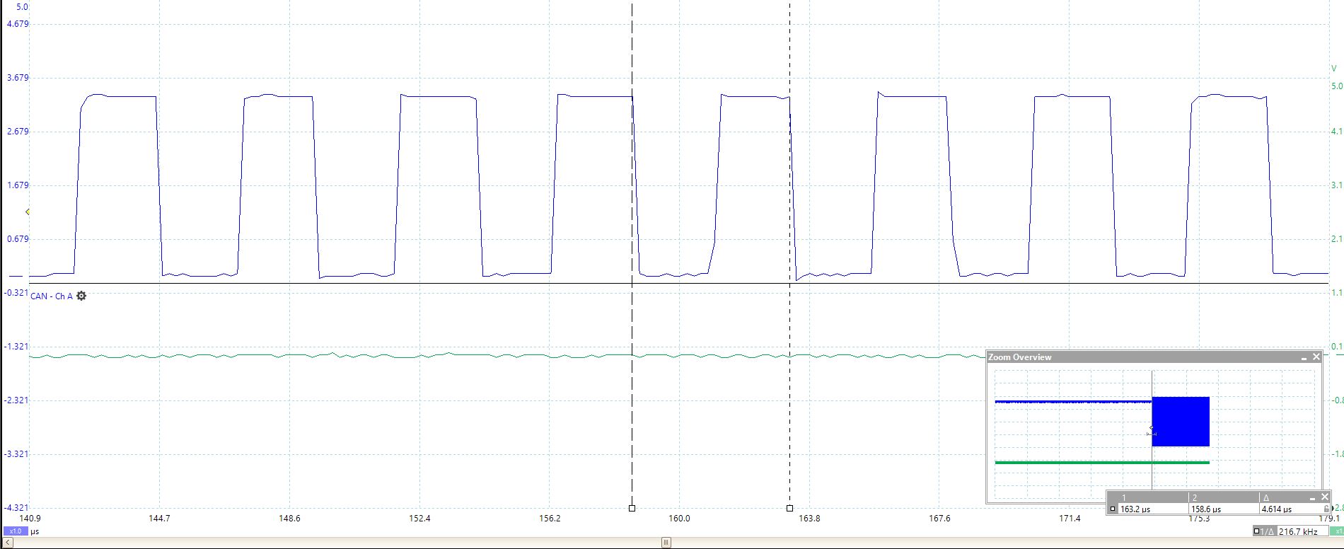

I am using 28379 at 500KHZ and using     CANBitRateSet(CANB_BASE, 200000000, 500000); to set the rate.
So to set the same baud rate for 28035 what should I have my registers for Setup.
I feel the baud rate is not correctly set since I  send 8 bytes on mailbox 25 from 28035 to 28379 but it in 28379 code in the Rx interrupt I always get the error bit set. I think I might have not correctly set the baud rate. Can you verify  that? thanks
ECanaShadow.CANBTC.bit.BRPREG = 6;
ECanaShadow.CANBTC.bit.TSEG2REG = 1;
ECanaShadow.CANBTC.bit.TSEG1REG = 6;
  • Assuming you are operating 28035 at 60 MHz SYSCLKOUT frequency, i/p clock to CAN module is 30 MHz. This means [Bit-time x (BRPreg+1)] must be equal to 60, for 500 kbps. Changing BRPreg to 5 should make it work.

    Please capture the waveform on CANTX pin on 28035 and send it. The waveform must be very clear like it is in SPRACE5. Specifically, I am interested in looking at the bit-period on the 28035 end. Do this experiment when 28035 is not connected to 28379. Mismatched bit-rate between nodes will cause lot of bus errors
  • Is this the output on CANTX pin of 28035? Looks OK but could you provide a scope capture. Would like to look at the bit-width.
  • Yes this from TX pin of 28035.
    Below is Screenshot when I have 28035 in TX mode and my blue pin connected to TX of 28035.
    Red is Rx from Transceiver on Launchpad of 28379 where I receive signal. So looks like all hw configuration is correct.

  • 4.614/2 = 2.307 uS, which translates to 433.463 kbps. I think 28379 operates at 500 kbps. It appears you didn't change the CANBTC values per my suggestion.
  • I think I did the same exact values as you mentioned and I have updated my last post with register values.
    I think I measured incorrectly before. Check the timing currently.
    Also, Tseg1 and Tseg2 of 28035 has to be the same with 28379(i haven't modified anything in 28379?
  • Now the bit-rate looks correct (500 kbps). TSEG1 & TSEG2 adjust the sampling-point for the bit. SP should be chosen based on the bus length, prop delay of transceivers, bit-rate etc. That is network dependent. Have you looked at the Debug tips in SPRACE5 and tried out the suggestions? If not, please try those first.

    I have seen in scope. I had posted a screenshot of tx pin of 28035 and Rx pin 28379 and posting again here. Is there any way I can see Mailbox RAM area on CCS?
    The scope waveform must be very clear. One channel should show the CANTX pin of 28035 and the other channel should show the CANRX pin of 28035. The waveforms must be identical on both channels, with the exception of the ACK bit. See Fig 4 of SPRACE5. That is how clear the waveforms should look like. Your waveform doesn’t look like it was captured on a scope. What tool do you use?

  • 1)I am using a PicoScope to capture the signal.
    2)So the waveform I shared doesn't represent the correct form of communication? It looks like it is the same signal but I am capturing at 28035 Tx Transceiver and 28379 RX Transiever and I am using VP234 as Transceiver.
    3) Yes, I have updated ECanaMboxes.MBOX1.MSGID.all = 0x00040000; on 28035.
    tCANMsgObject sRXCANMessage;
    sRXCANMessage.ui32MsgID = 0x00040000; Should make it to 0x01 right in 28379D ?
    Is there a way I can See if there Mailbox Ram directly?
  • 2)So the waveform I shared doesn't represent the correct form of communication? It looks like it is the same signal but I am capturing at 28035 Tx Transceiver and 28379 RX Transiever and I am using VP234 as Transceiver.
    No. I clearly mentioned as follows in my previous post:
    "One channel should show the CANTX pin of 28035 and the other channel should show the CANRX pin of 28035. The waveforms must be identical on both channels, with the exception of the ACK bit".
    SPACE5 explains why and there is even a scope shot that clearly identifies the ACK signal.
