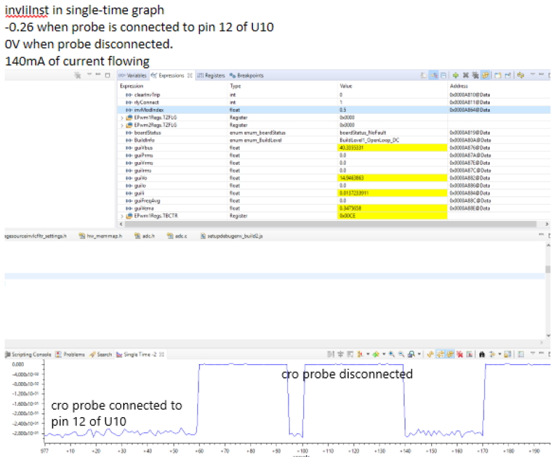

  • Have worked out how to paste images...
    This screenshot is of invIiInst input to ADC A2, with me toggling Vbus voltage between 0 and 380VDC, current transitions between 0A and 1.64ADC, measured at the resistive load.
    This screenshot is of the output form the current sensor / input to the opamp, pin 12 of U10. Seems to indicate some sort of loading issue? Wasn't expecting it as the probes are high impedance...
    Time is getting away on me, I had expected to have resolved this by now (I had assumed it was human error on my behalf, however the longer it takes to resolve the less I am inclined to believe this)
    Robin
  • Robin,
    For the DC check, please check the instantaneous values, guiVo and guiIi, this will give you an idea of how much off you are on the board.
    guiVo=invVoInst*VDCBUS_MAX_SENSE;
    guiIi=invIiInst*I_MAX_SENSE;
    I'll recommend not connecting any probes that are not mentioned in the UG as that puts the board under conditions that it was not tested with.
    -Manish
  • Hi Manish,
    I set the Vbus level such that I had 0.5amps output to the resistive load.
    Vo (measured) = 59.9VDC
    Iinst(measured) = 0.5Arms
    Wrt the probes, I'll stick with the TPs, but i was cognisant of introducing any ground loops etc through the cro ref lead.
    Robin
  • Robin,
    I'll probably pass the Vac sense as well, but Ii should be better. As I am unable to determine the issue, i will approve a replacement of the board.
    You will need to contact the channel through which you got the board for a replacemet and point them to this thread.
    Manish
